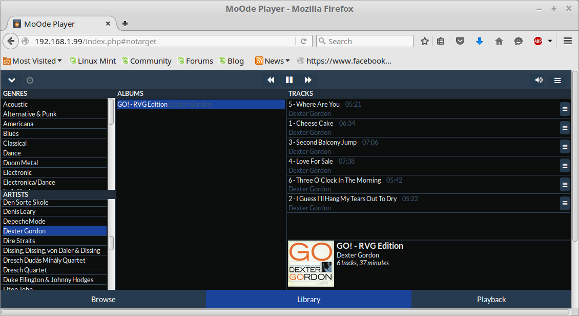

I installed 2.5 TR3.
Very easy!
A few questions I didn't find in the forum:
Rescanning the NFS library took more than an hour. On TR1 and 2.4 it was maybe 10 minutes. I'm on the same machine, the same network and the NFS share is the same. Any ideas?
When browsing albums in the library the order of songs on the album is screwed up. It must be the GUI - other mpd clients displays the order correct. Did I do something wrong?

I don't recall making any changes to NFS code in 2.5 that could affect throughput but nonetheless it may be a regression bug or unintended side-effect bug from a seemingly unrelated change between TR1 and TR3.
Here are the 2.5 relnotes entries pertaining to NAS mounts
- UPD: Changed CIFS mount rsize/wsize to defaults rsize=61440 and wsize=65536 for improved throughput
mount
- UPD: Differentiate between CIFS lazy umount and NFS force umount
Couple of things that can be done to troubleshoot:
(1) Turn on MPD logging and examine the log for anything suspicious
(2) Run an A/B test in your current environment using A=TR1 and B=TR3 using same Pi and see if u can reproduce the same result of 10 mins vs 1 hour mentioned in your post. If same results, I can investigate 🙂
With regard to the sort order issue, please zip up some tracks from that album and send download link to tim at moodeaudio dot org and I'll investigate 🙂
