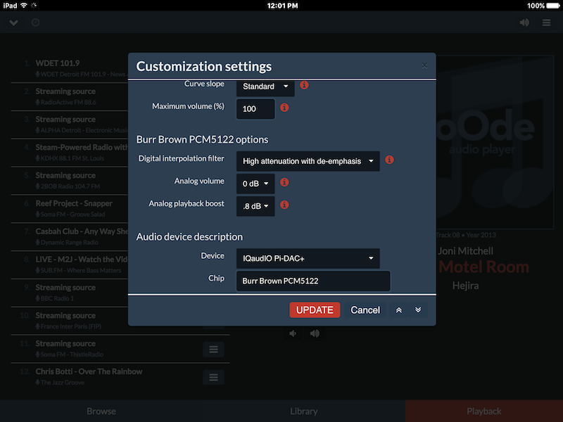

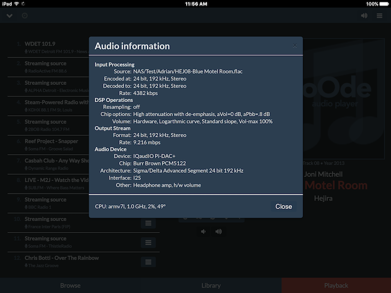

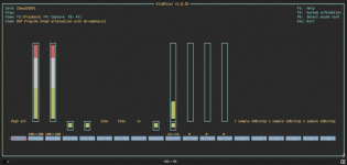

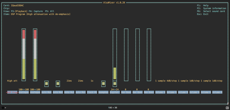

Hi there.
I'm not running Moode ( I'm a squeezelite fan 😉 ) . But that shouldn't matter at this point.
I'm currently running a HifiBerry DAC+ Pro. That's why I jump in.
I saw that you just implemented a mask to set the interpolation filters for that DAC.
You might have seen that I've been posting about the filters and my experiences.
My preferred filter is the high attenuation filter.
However. In my setup it works up to 48khz only. Beyond that there are nasty distortions added.
My question: Do you experience the same behavior? If yes. Have you applied any precautions to avoid that issue?
Thx.
Yes, it was your thread plus a post in this thread by a user that preferred the -6dB setting for Analog volume that motivated me to implement an easy way to change pcm5122 options -- thanks! 🙂
I ran a few tests with IQaudIO Pi-DAC+ using the four filter options and 24/192 flac file and no issues. I don't have Hifiberry DAC+Pro to use for testing so can't rule out a device or driver issue.
Tim

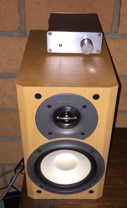

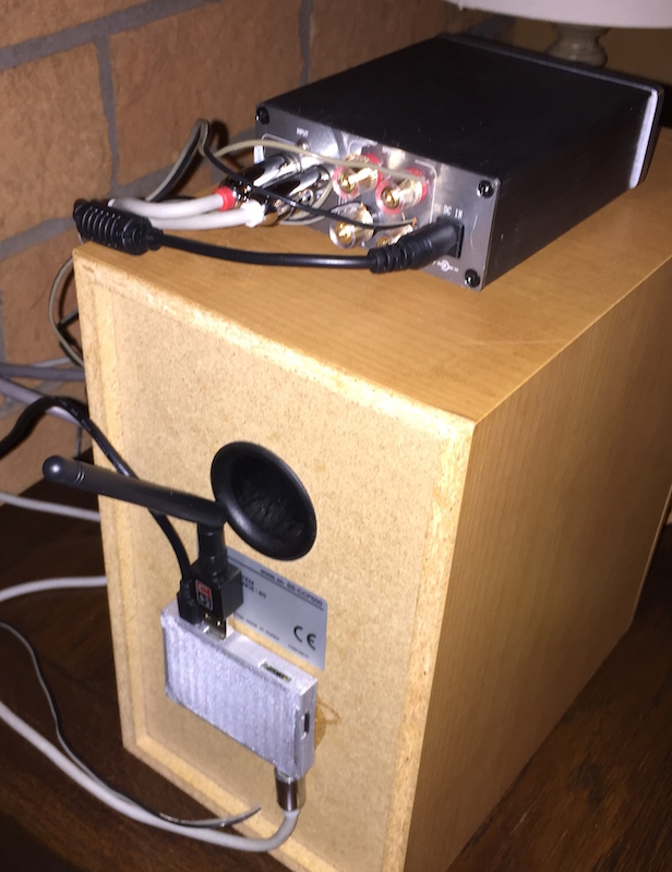

As I've said a couple of days ago, I've got another PiZero with Plain DAC and a nice,3D printed case from the manufacturer of the PlainDAC.
Here's the final effect.
The player is attached to the back side of the speaker using regular, double sided tape. The amplifier is a mini device based on TPA3116 giving more than enough power.
Everything works perfectly thanks to MoOde.
Now, I can MoOve (😉) it to the bedroom 🙂
p.s. so now, I have 2 MoOde based players 🙂
