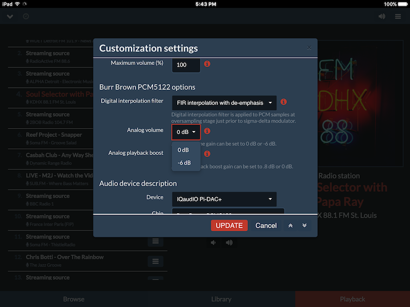

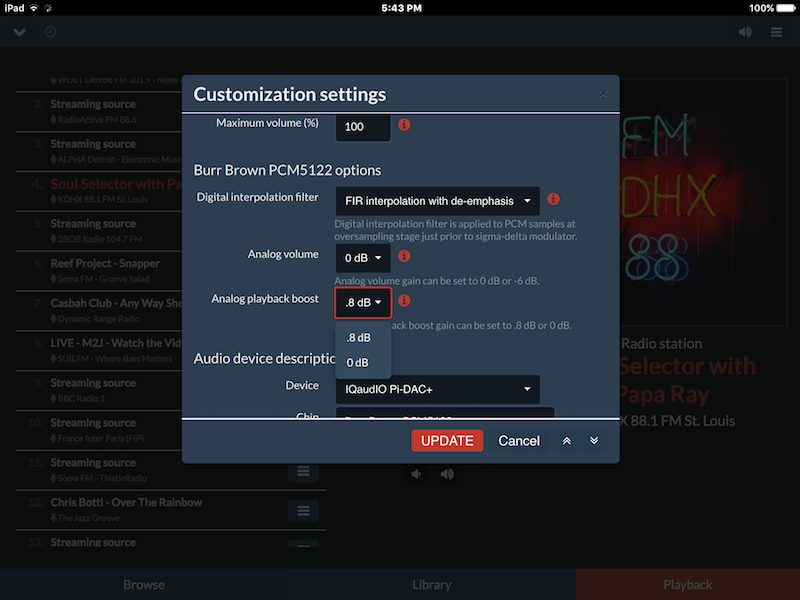

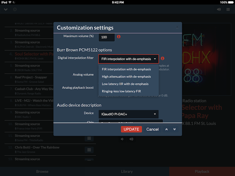

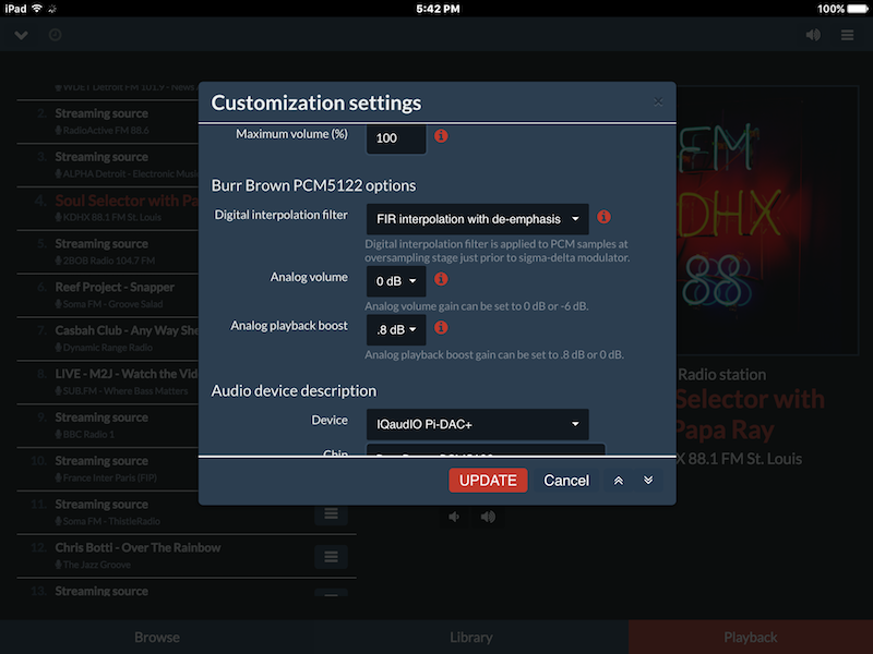

Attached are some screenshots of a new Customize section for PCM5122 options. The settings take effect in real time.
Tim
