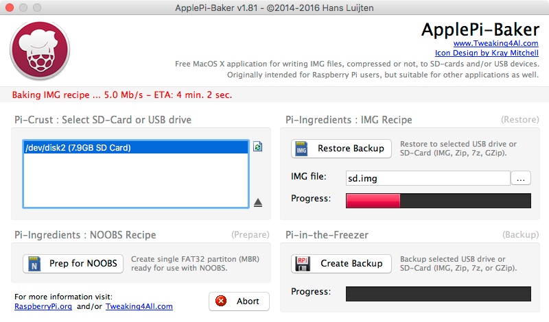

Thought I'd mention that Rob over at The Art Of Sound posted about an image writing util for Mac OS X called ApplePi-Baker written by Hans Luijten. Its easy to use and fast at writing SD card images. I'm guessing it specifies raw disk (of=/dev/rdiskN) to get fast write I/O 🙂
Download
Tweaking4All.com - MacOS X - ApplePi Baker - Prep SD-Cards for IMG or NOOBS
Tim
