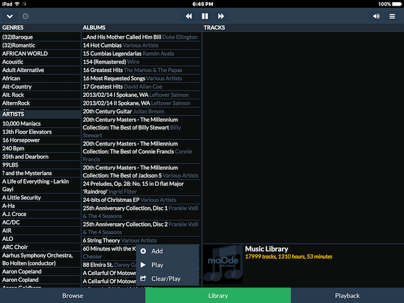

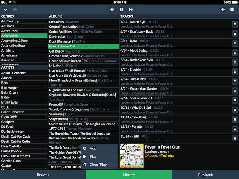

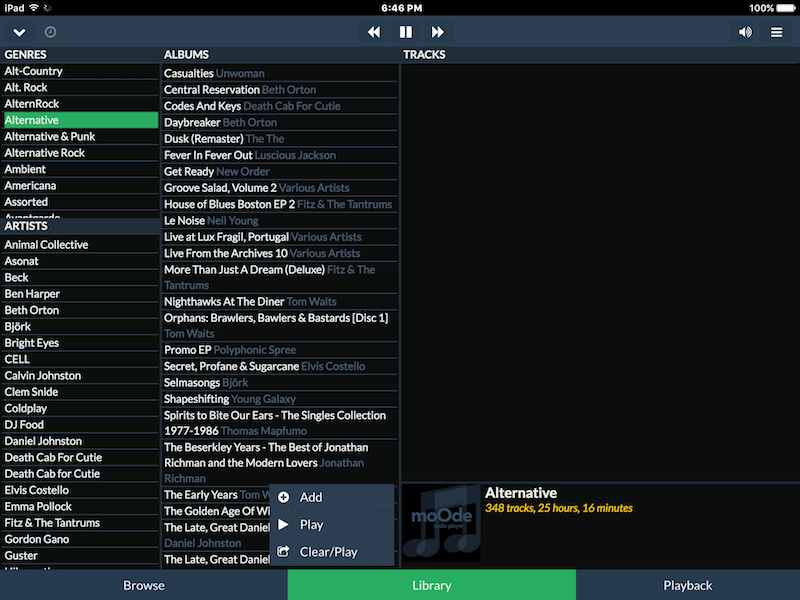

Here are some screen shots of the new Library panel menu that is displayed after clicking on cover art.
The menu items Add, Play, and Clear/Play apply to whole Genre, Artist or Album, or the entire collection. The track count is highlighted when the menu is displayed as a cue.
I've also used a tint of Flat UI "Wet Asphalt" color to lighten the artist name so it stands out a bit more from the background.
Tim
