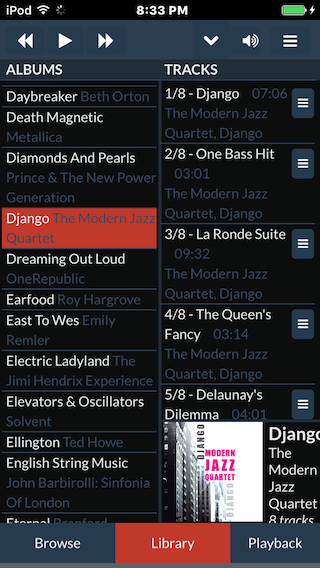

Btw, as @morias mentioned, in Browse, you have to click and navigate the folder heirarchy.
Moving the (all) menu selections from the Tracks action menu to an action menu button for each Album might be possible. The challenge with having three individual buttons on an Album row is density on small screens.
Attached is screen shot of an iTouch (same as iPhone 5)
Tim
Tim
