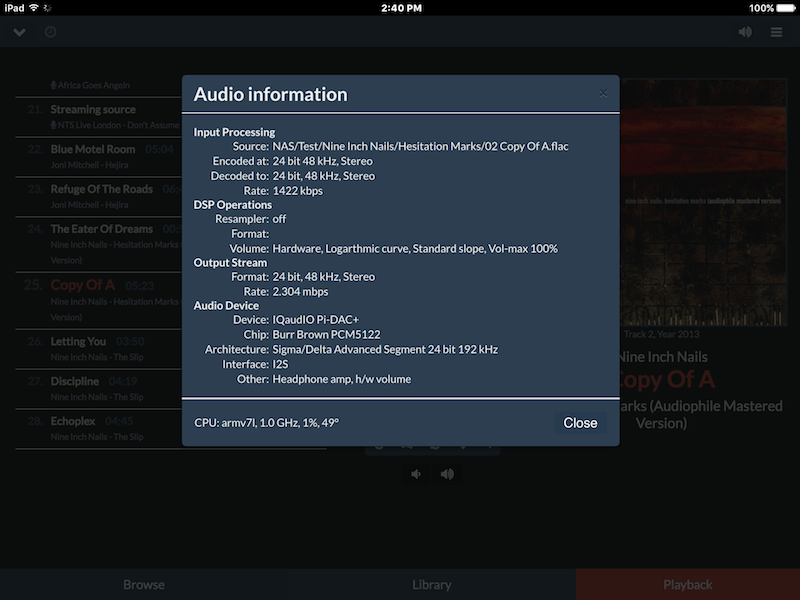

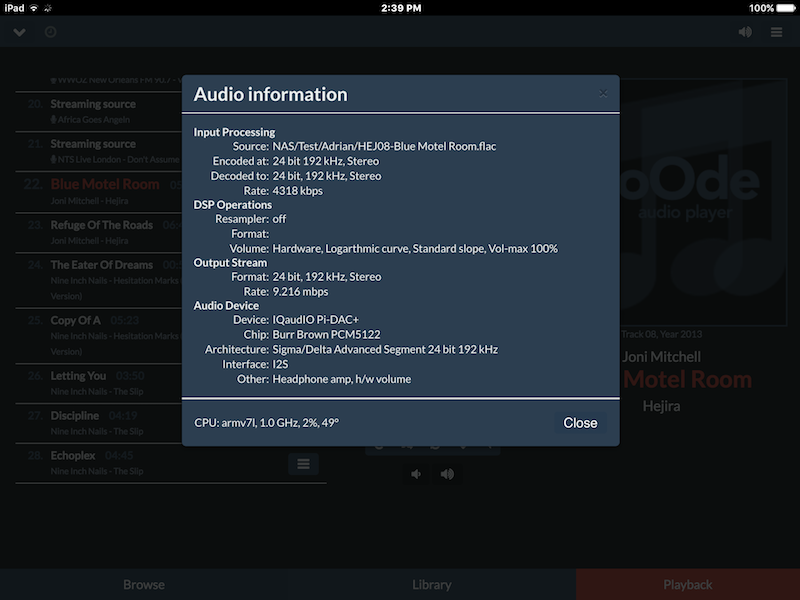

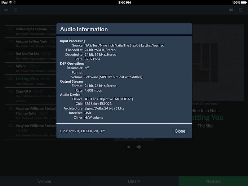

Here are some screen shots of Audio info popup with new "Encoded at" field. Its the actual bit depth and sample rate used to encode the song file. Note that for radio stations this field will always contain the string "VBR compression".
Tim
