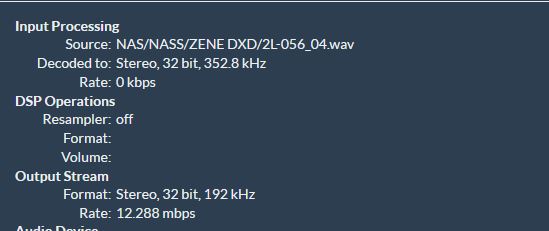

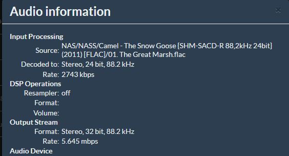

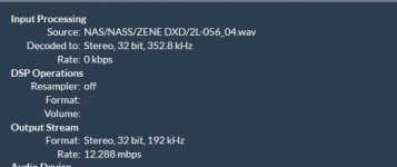

Hi Tim,
Thanks for your answer and your work!
1, I use 2.4 version that issue come if the Customisation AND the System configuration switch DAC PRO if the Sys Conf remain Digi+ the setting remain I2S, otherwise chang to "nothing select".
I really not know what setting change the overlay
2, I test is and other than 44.1kHz 16 bit the output always 32bit(sample picture below)
3, The output is remain 192kHz and not goes above than.
Thanks Richard

Hi Richard,
The Customize setting for Audio device is just for display on the Audio info popup, it does not result in any internal configuration.
Try release 2.5+ TR1 from TEST CODE at moodeaudio.org.
Tim

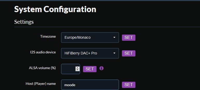

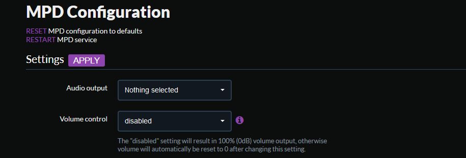

Hi Richard,
Tim
Thanks, I try but same, Hifiberry DAC Pro+ no I2S output.. se the picture
Thanks Richard

I test on TR1 image w/Hifiberry DAC+ and also "I2S audio device" = DAC+Pro even though I don't have a Pro they both use same i2s driver. No issues.
After reboot, MPD config screen shows "Audio output" = "I2S audio device"
NOTE the Hifiberry devices clip at amixer volume > 81%. Optimal Moode config to compensate for this is:
- MPD config: Volume control = "Hardware"
- Customize, Hardware volume control
(a) Logarithmic curve = Yes
(b) Maximum volume % = 81
Tim
