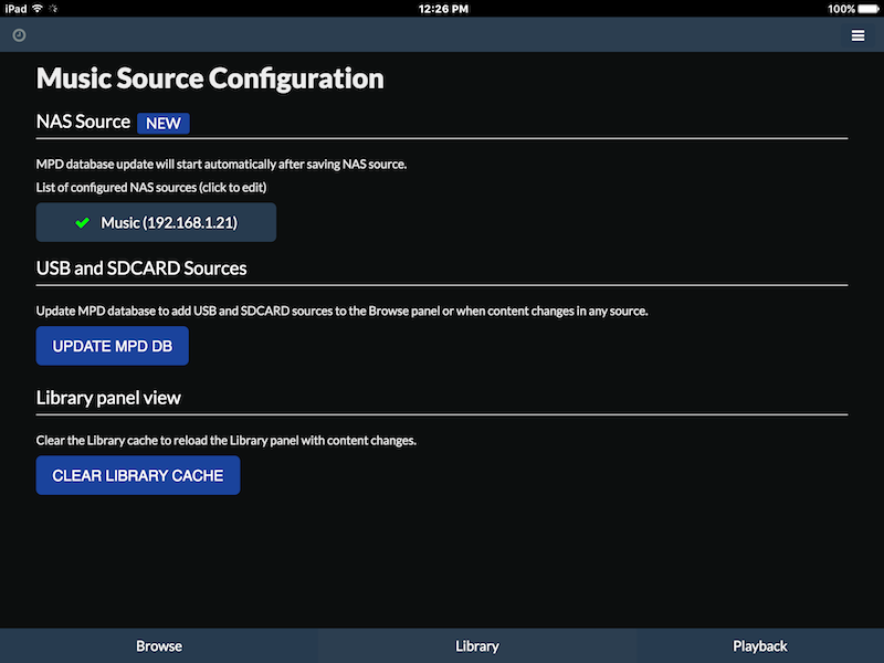

Just a brief update on TR2 🙂
A new caching Library loader with enhanced capability for large collections is done.
Once cached on the server, the Library loads very fast. A couple seconds for 20K tracks from USB HDD. Page refresh or reboot won't cause reload of Library, the cache will be used until it's manually cleared, then Library will reload (to get new or changed music for example) and new cache created. The cache creation only adds a small amount of overhead to Library load.
Enhanced large collection capability is courtesy of diyAudio user "anewnadir" 🙂
Tim
Great to hear. That "slow" library loading was one of the shortcomings when comparing to other audio solutions.
