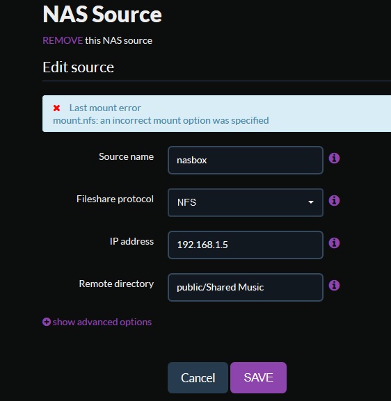

I've been using Raspyfi / Volumio / Rune for a few years . No matter what I do I can't mount my NAS on Moode .
316a
From my experience: I've had to use SMB (NFS never worked) and user/password from NAS to get access (my NAS is WDC MyBook Live) and user "ro" mount option (advanced settings). It worked like a charm after that.
Marek
Have removed and added source , toggled between fileshare protocol . I just can't get the magic green tick
316a
Marek

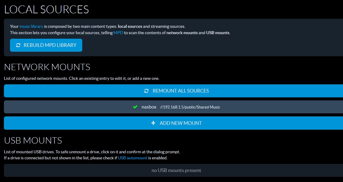

I'm also using a Mybook and that appeared to work . Thanks :)
Now have the spinning updating arrow
316a
Marek
For SMB/CIFS these are default mount flags:
cache=strict,ro,dir_mode=0777,file_mode=0777
What did u need to add?
