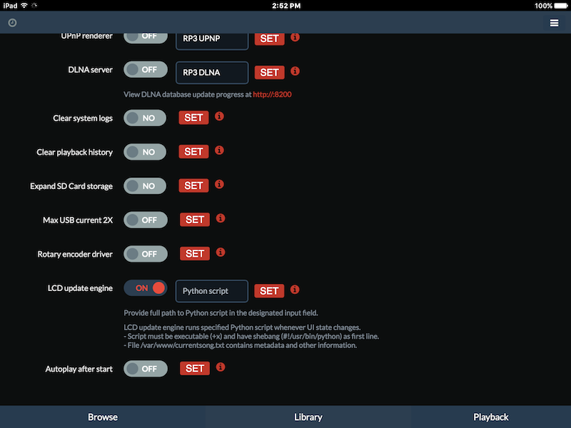

Here are some screenshots of a few more new features in Moode 2.5 🙂
(1) LCD Update Engine
This feature provides an inotifywait based engine that runs a user specified Python script whenever Moode UI changes. The script simply needs to parse the file /var/www/currentsong.txt to obtain the information below, then update the LCD panel.
- artist
- album
- title
- coverart url
- track x of y
- date
- composer
- encoded: (ex: 16/44.1)
- volume
- mute

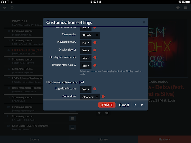

(2) Resume After Airplay
This feature restores Moode volume after Airplay session ends, then begins playback.
