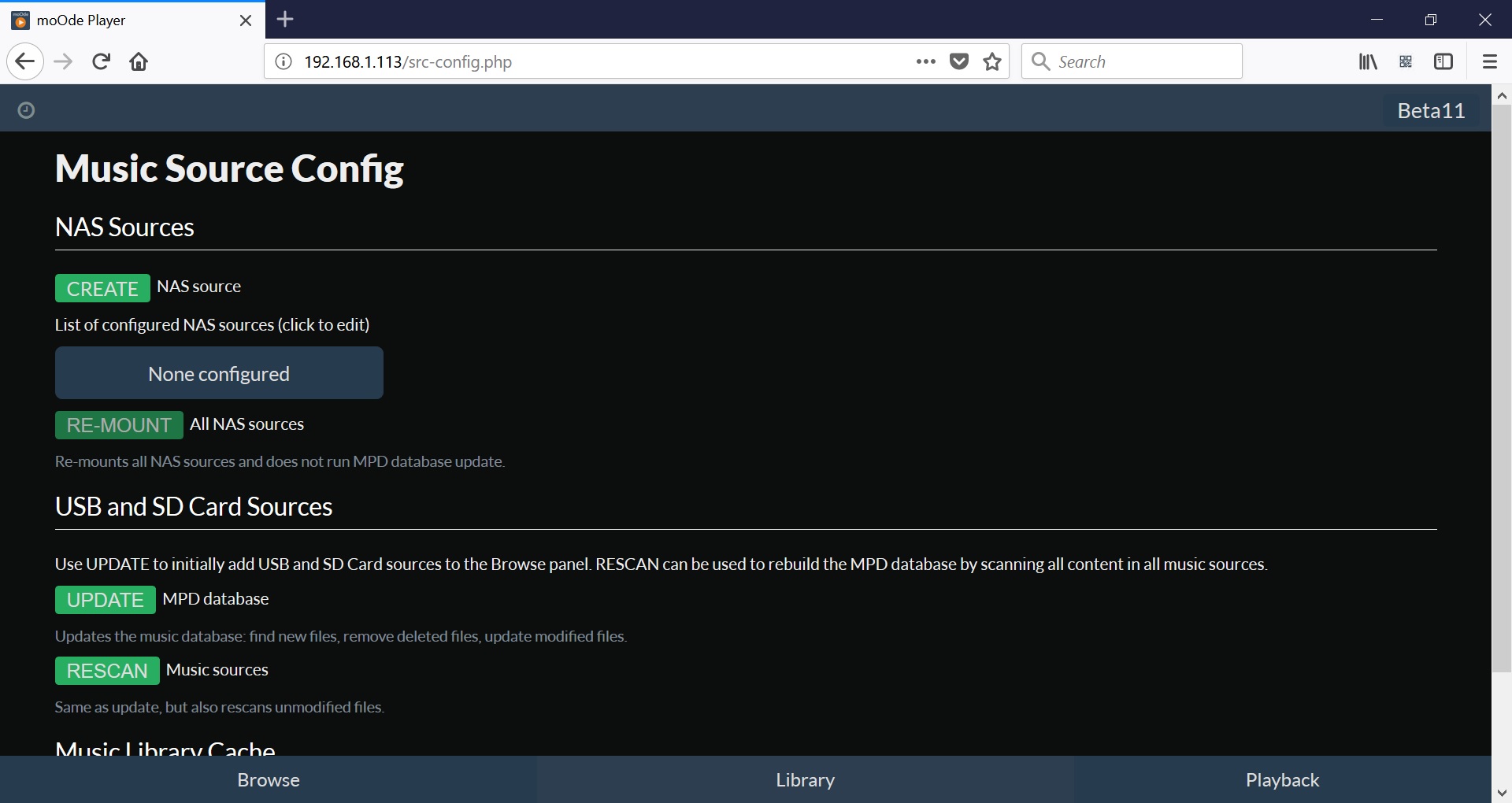

Did you click Update the MPD sources? You have to do that initially, then you can rescan thereafter when you change/add/update your music library.
Also, what format is your drive partition? And what size?
Thanks for being helpful!
I did click Update the MPD Sources - the sources list didn't contain neither the USB drive nor the NAS source beforehand. What's even more weird, although there is a NAS source in the Sources tab (which is false, since the only external source is the USB stick I plugged into the RPI USB port, and it resulted in a NAS being added to the Sources list after trying to update the MPD sources), the Music Source Config page says that there is no NAT configured (which is true)-see attached screenshot. This is exactly the cause for me to suspect there is a bug in this release of Moode (I used the very same stick on the older release, which was 2.something).
As for the USB thumb drive, it gets automounted by Raspbian, and its characteristics are:
pi@moode:~ $ df -h
Filesystem Size Used Avail Use% Mounted on
/dev/sda1 29G 8.4G 21G 30% /media/USBMETAL
pi@moode:~ $ mount
/dev/sda1 on /media/USBMETAL type vfat (rw,nosuid,nodev,noexec,noatime,nodiratime,fmask=0022,dmask=0022,codepage=437,iocharset=ascii,shortname=mixed,showexec,utf8,errors=remount-ro,uhelper=udisks)
Thanks in advance for any help!

@mario74m
I'm running r40b11 on an RPi3 without any NAS configured and with a USB thumbdrive containing music files. I don't see the behavior you report.
In the Browse panel, I see a "NAS" folder (note-it's in uppercase, unlike the "nas" folder I see in your image. That seems curious.) There is no content in the NAS folder, as expected. I also see a "USB" folder. In it is a MUSIC-A folder (the name I gave the drive) and in the MUSIC-A folder is music content which subsequently shows up in the Library panel. The system directory information for this thumbdrive is similar to yours.
Hope this helps.
Kent

@mario74m
Hope this helps.
Kent
Thanks for your effort.
Yes, the "nas" folder is really lowercase in my case. What's more curious is that it disappears after each reboot, and returns after a MPD DB Update.
A peek into /var/log/moode.log reveals the following:
20171204 225753 worker: - Network
20171204 225753 worker: eth0 exists

So, the thumbdrive does get detected by the system, but trying to add it as a source results in the behaviour described.
What does /var/log/mpd/log look like?Thanks for your effort.

So, I did the following:
sudo rm /var/log/mpd/log
sudo touch /var/log/mpd/log
..Restart Moode via GUI. Thumbdrive plugged in.
..Checking that the logging level is set to Debug via GUI
..Checking the Sources in GUI after reboot. The list consists of RADIO, SDCARD and Default Playlist
..Clicking UPDATE (MPD Database) in Configure | Sources
..Checking the Sources again. A lowercase "nas" entry appears in the list, after SDCARD and before Default Playlist
cat /var/log/mpd/log yields:
Last login: Tue Dec 5 07:36:10 2017 from 192.168.1.147
pi@moode:~ $ cat /var/log/mpd/log
Dec 05 07:43 : avahi: Service 'Moode MPD' successfully established.
pi@moode:~ $
There's no mention of the thumbdrive in the log whatsoever, which is very strange.
Another thing is that the moode build went really smooth and according to the recipe, without any errors or warnings.
I will try low level formatting the drive in the afternoon, or try another drive, and report back.
Anyway, thanks for your time everyone 🙂
