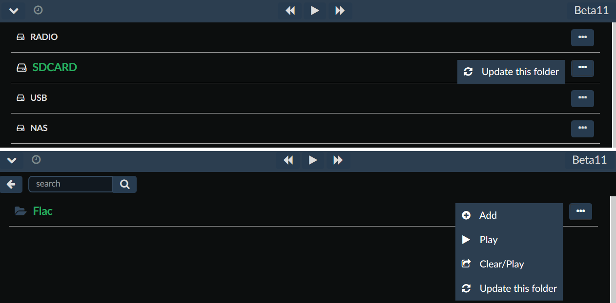

I upgraded to beta 11 from beta 9 but I still have the message : 'cover art not found'
As you can see, Tim got it
Just wait for the beta12

I have installed moode 4.0 beta 11 without problems and it works. After that I copied my music files on the SD card, and I see them in the moode library. The problem i'm having is that i can't select to add all songs from the sd card on the playback list. I can only add 1 song at a time. I lost the option to select all songs at once.
