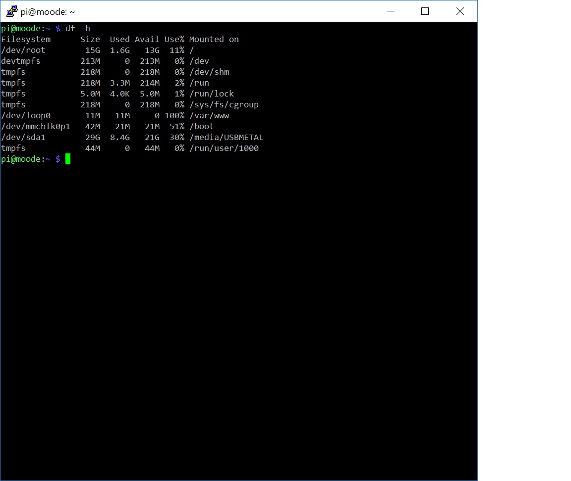

Just a brief update. The new fully automated moOde image builder is almost through the testing process. I'll be releasing it at the same time as Beta 12 🙂 The Builder is a download from moodeaudio.org and will also be included in moOde 4 itself going forward.
It's a simple two phase build.
Phase 1 runs on an existing Raspberry Pi that has SSH enabled. It builds a new base OS image on a USB Stick or USB-SDCard which is then used as the boot device for the second phase. See below for the output from Phase 1.
Phase 2 is completely headless but can be monitored from an SSH session via tail -f on the build log. I've included pre-compiled MPD and Squeezelite binaries to shorted the build time. An example of the log from Phase 2 is provided below. I had to strip out most of the cmd output due to forum post word count limits. Note how the automated process exactly follows the manual Build Recipe.
This was made possible by the truly wonderful work from @Koda59 🙂
-Tim

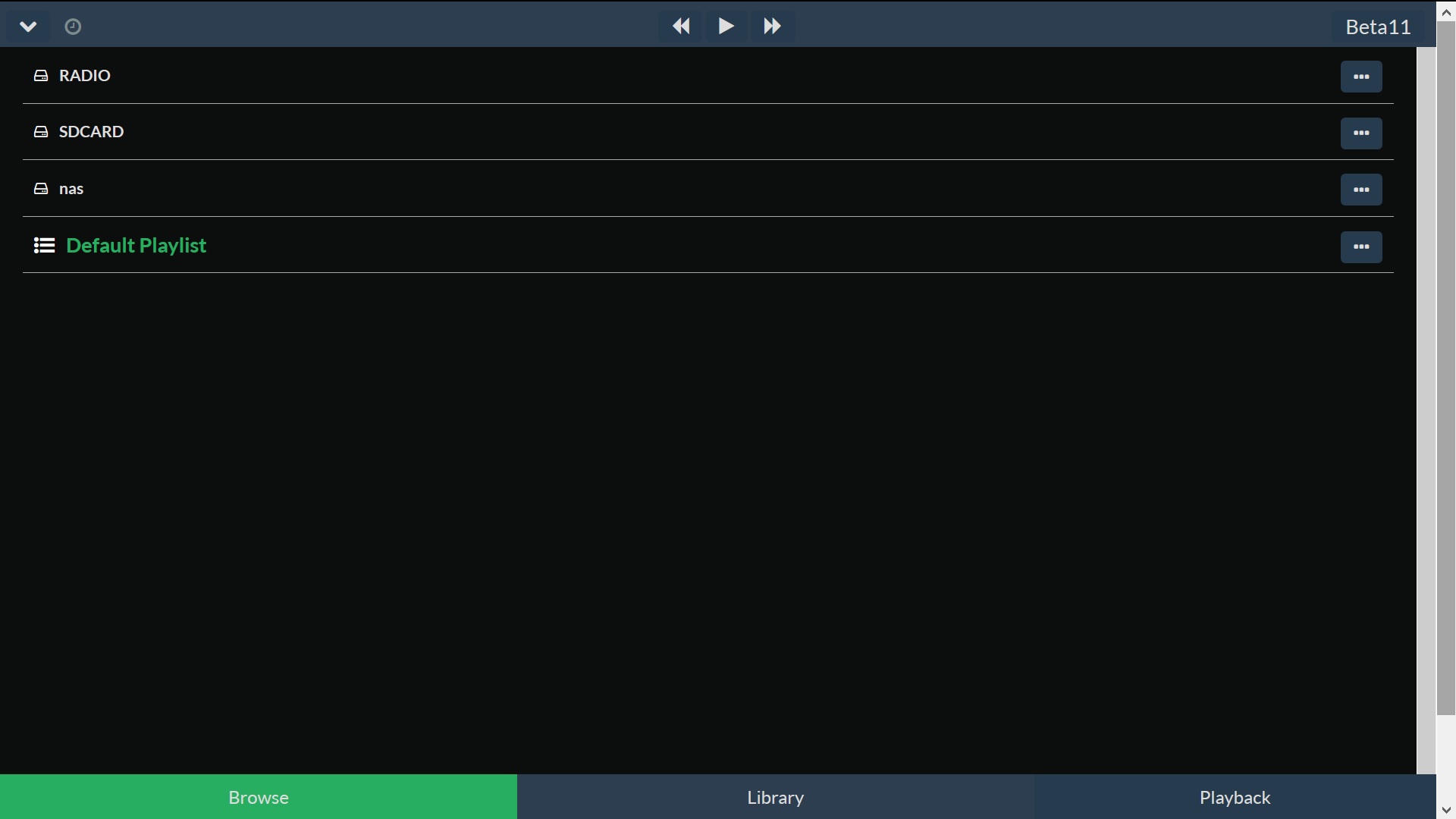

Tonight I built a 4.0beta11 image, and I have a problem with accessing an USB drive source. After connecting a stick and rescanning the sources, a new "nas" source appears in sources list (whereas I don't have a NAS), while the USB volume doesn't. Nevertheless it gets recognized by the OS. Screenshots are attached (the USB volume is named "USBMETAL").

First of all, thanks to Tim for an incredible product!
Did you click Update the MPD sources? You have to do that initially, then you can rescan thereafter when you change/add/update your music library.
Also, what format is your drive partition? And what size?
