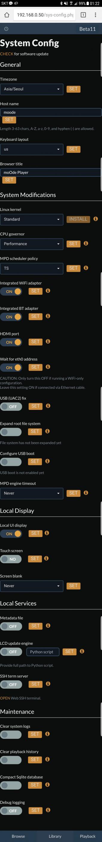

Is the System config screen in moOde. Its same screen where you turn on the Local UI feature.
Menu, Configure, System
-Tim
Hm, that is what I checked at first. Screen blank is set to 'never'.
That's why I am looking for alternative way like xset :)

Tim, when "never" is chosen in moOde, the variable scnblank is set to 600000 (seconds) which is about 166hr. Where did that value come from? It seems safe enough, although it would seem the same problem will show up in about 7 days if the Xserver isn't restarted in the meantime.
However, from an answer I found buried in the discussion of power on display via ssh
Alternately, you could just set the timeout value; it seems to have a maximum of 20864 (a little under 6 hours)
I don't know the basis for that statement but maybe values greater than 20864 are ignored? Candidly, I don't relish digging through X11 source code to find out.
@horsesam, what happens if you choose "1 Hour" for the screen blank interval?

I have found that with the screen blank value set to "never" the screen still does blank, but it does not take as long as 7 days. I think it is closer to 1 day. For what it is worth.
After testing it looks like setting below works.
xset s off
I'm not sure if "xset s noblank" is also needed.
-Tim
Tim and @horsesam
Kent
I just found when I change webUI > system config > Local Display > Screen blank option, it changes .xinitrc.
and, tried "1 hour". However, the display turned off after 10 minutes.

[Unit]
Description=Start Chromium Browser
After=nginx.service php7.0-fpm.service mpd.service
[Service]
Type=simple
# start xserver
ExecStart=/usr/bin/xinit
User=pi
[Install]
WantedBy=multi-user.target
pi@rp2:~ $
