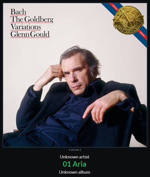

Library uses Genre, Artist and Album tags. If any of these are missing in the files they get assigned the pseudo-tag "Unknown".
- If files show up in Browse but not Library then most likely missing tags.
- If files don't show up in Browse then its most likely corrupt files or file headers, or sometimes permissions. MPD log flags such files with error message.

Hi Tim,
I checked my mpd.log for my Glenn Gould example above Post 7465 ("Unknown artist/Unknown album"):
Code:
Apr 26 18:47 : player: played "SDCARD/FLAC-HD/Grover Washington Jr/Winelight/04-Take Me There.flac"
Apr 26 18:51 : player: played "SDCARD/FLAC-HD/Glenn Gould/75 - Bach - The Goldberg Variations, BWV 988 (1981)/01 Aria.flac"
Apr 26 18:52 : player: played "SDCARD/FLAC-HD/Glenn Gould/01 - Bach - The Goldberg Variations, BWV 988 (1955 mono)/01 Aria.flac"
Apr 26 18:58 : player: played "SDCARD/FLAC-HDGrover Washington Jr/Winelight/05-Just The Two Of Us (feat. Bill Withers).flac"
I can confirm what you said:
- I can browse the files
- but files are not listed in library
- no errors in mpd.log
