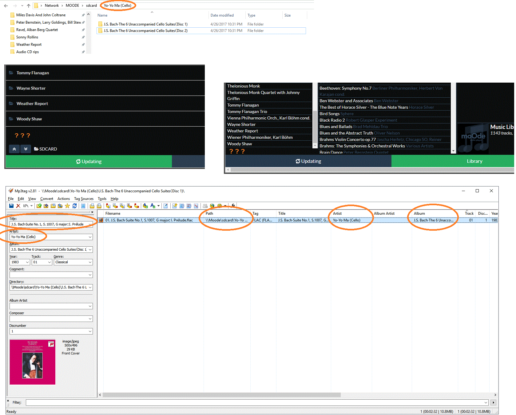

1) Some entire albums worth of music tracks simply do not display in Moode 3.1's Browse or Library panels. However, they do display and play without issue in Foobar2000 and Windows Media Player in Windows 10. Tim may be right--it could be that the files got corrupted when I backed them up and copied them back onto the SDcard. But why then would the files play and display perfectly well in other media players, and all their ID3 tags display fine in Mp3tag? I even tried rewriting the ID3 tags in the files, but this didn't help. I guess I need to trash these files and rip them from CD again. (Argh.)
2) Album cover .jpg files don't always show in the Library panel. If I open those files in any image file viewer, they display fine. It's just in Moode that they don't display. I don't know why. I guess I need to download a suitable image file directly to the sdcard, in the folder with the album's music tracks.

How long does it take the MPD database to update for 50GBs' worth of music files?

There are no naming requirements for cover art files but Moode will first look for embedded art, then files named F(f)older, C(c)over .png .jpg or .jpeg in the directory containing the song file, and lastly for any image file in that directory.
To troubleshoot, examine mpd log after update/rescan to see what MPD thinks about the files.

Well, I'm a moron. I can't save a simple text file in the RP3 from Putty. I got in, ran vim, but either I can't figure out the necessary keystrokes or something's up with the way my USB keyboard is interacting with moode OS from Putty on my lousy laptop. So I gave up, and decided to do a re-rip of one of the CDs that aren't showing up in the Library or Browse panels.
The exact same thing is happening. Even after two times doing Configure > Update MPD, the new tracks are not being displayed.
I saved the folder full of music files to the sdcard (from within Windows, Network > MOODE > sdcard). The folder "Yo Yo Ma (Cello)" appears there, with two subfolders, "J.S. Bach‧The 6 Unaccompanied Cello Suites(Disc 1)" and "J.S. Bach‧The 6 Unaccompanied Cello Suites(Disc 2)".
Exact Audio Copy reported no errors in the rips. They were compressed to FLAC, like all the other files I'm storing on the SDcard. But Yo Yo Ma does not appear in the Artist list in the Library panel and Yo Yo Ma (Cello) doesn't display in the Browse panel.
So file corruption doesn't seem to be the problem, does it?

I noticed the name has an acute accent on the track name and I wonder if that has something to do with it?
Can you rename/retag with a plain ascii character in place of the accented character and see if it makes a difference?

works ! thank's

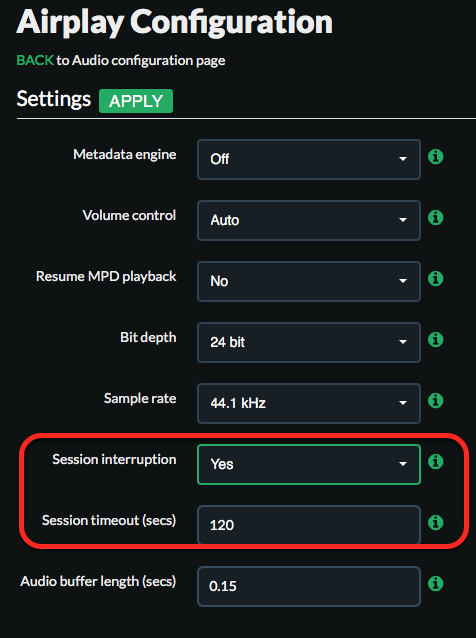

when Airplay > Session interruption is ON I would like to set the Session time-out to infinity. Is that possible (i.e. to enter 0 into the session time-out field ?
Prolly, but whats the usage scenario for 0 secs?

so that I don^t have to re-select Airplay after 120 seconds of non-use. I have a dedicated "iphone" to play music. OK, I could also enter 1200000000 seconds (or 38.05175038052 years) to be safe from that for a while ! but it just seems more elegant to turn the time-out Off completely
Makes sense. I'll add to TODO list.
Have you already verified that setting it to a really large value prevents the session from being closed?
