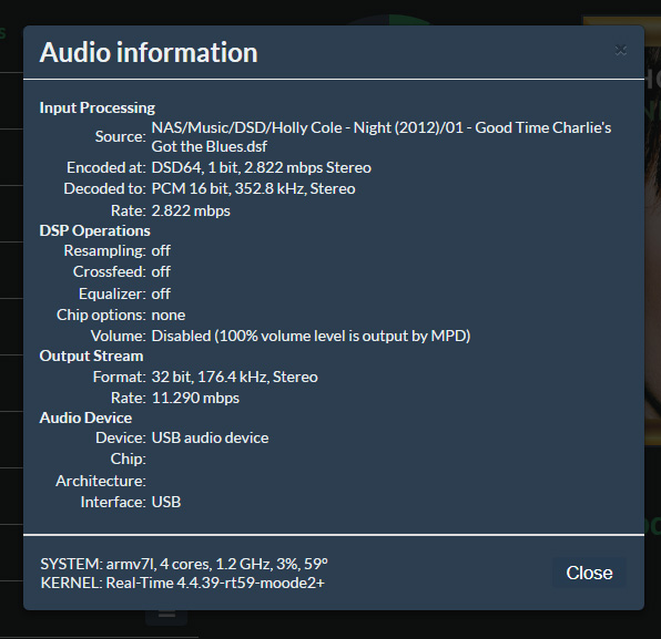

When I try to play DSD file on moode 3.6 to USB DAC, the audio info shows following...
I'm don't unerstand why decode PCM 16/352...
All my USB DACs support native DSD up to 256. In moode DOP settings switched to "yes". Can anybody explain me...
Thanks for pointing this out. Its just displaying wrong info due to not checking the DoP setting.
It should probably be something like below for DSD64 and DSD128.
Decoded to: PCM (DoP) 16-bit 176.4 kHz
Decoded to: PCM (DoP) 16-bit 352.8 kHz
I'll fix in next update.
