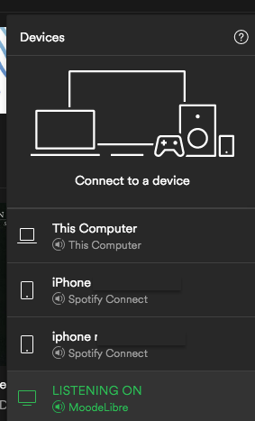

Librespot
I gave librespot a try, installed it according to the above instructions (thanks) and can see it in Spotify which seems to indicate that its working 🙂
When it is selected in Spotify (computer or phone), no sound can be heard. Are there some other configurations to be made ?
Thank's
Thank's
Thank's
Are you using USB DAC by any chance? Try to put --device plughw:0 instead of --device hw:0 (assuming that your audio device is numbered as :0). Some DACs (and audio interfaces in general) moan about the 44000/16-bit direct sample rate and hw:0 will enforce the sample rate as per stream, as part of direct hardware access policy. In essence, plughw:0 will apply necessary input format conversions for the DAC (assuming 24/32bit depth rate).
