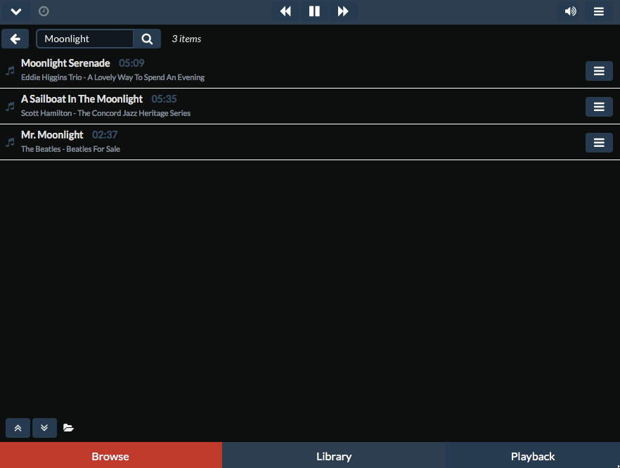

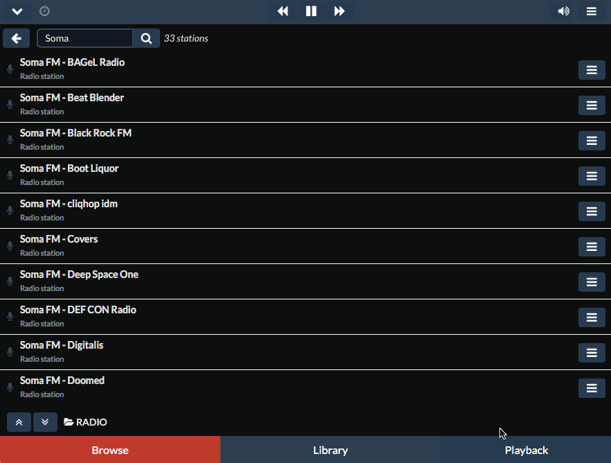

Upgraded to 3.6. Somehow I don't seem to be able to save playlist. Can someone provide steps please?
One enhancement request- the search feature does not search track name, it searches only album name. Can you enhance the search capabilities? How about search of radio stations?
Try another browser.
Clear Browser cache and history, and don't use the name RADIO as first part of a playlist name.
Search for radio stations or tracks is already in Browse panel.
-Tim

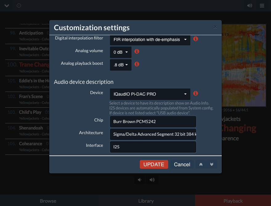

Hmm, that's strange ? In "Customize" there is a Piano2.1 Plus option. I'll try without that option. Not using SQL. Playing sound directly from NAS or Radio is OK.
On Customize, the Audio device description entry is just for displaying something on the Audio info screen. Its not a driver config. See help text below.
-Tim
