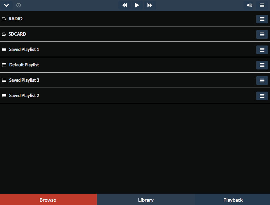

Just tried it here. Playlist file is not being saved.
Phil
@Phil, @Rob,
Just tested on Pi that runs the release image and on another that was bumped to 3.6 via in-place update and no issues.
After saving a playlist the file is written to /var/lib/mpd/playlists directory. Verifying via ssh that the file was successfully created would rule out a bug in that particular routine.
Btw, the bug that was fixed in 3.6 was that the save button was dead.
-Tim

Did an in place update from 3.5 and it doesn't work. No file saved, save button still dead. How can I force it to re-update?
Or which file needs editing so I can try to fix it myself?
Oh, looks like a browser or caching issue as it works from my laptop, but not my phone.
I'll investigate further.

In my case save button is still dead- no response at all when pressing. Made a fresh 3.6
installation. Am using Pi 3.
With 3.1 saving playlists worked flawlessly.
Strange that- maybe a Chrome Issue?

Seems to be a browser related thing. If you clear chrome process then open Moode again- it works even with Chrome- but it isn't possible to save an individual playlist- name- independent of which browser one uses. I only got ' radio station' despite I typed RADIOSPEICHER for saving
Can't get it to save in Chrome on Marshmallow under any circumstances - even after clearing Chrome's cache and rebooting the phone.
PlayList saving doesn't work proper- regardless which browser is engaged- there must be something broken.
Hi Rob,
I think I might have a repro. Strangely, it appears to have something to do with the presence of the name RADIO in the playlist name.
Until do a more thorough analysis avoid using RADIO, NAS or SDCARD in playlist names.
-Tim
Hi Tim!
You might be right! If I type big letters like 'RADIOSPEICHER' as playlist name, stations are saved as 'radio station' which you cannot delete. It shows like a radio station under 'Radio' in the browse- area.
If I type 'Radiospeicher' as playlist name- it works with no issues;-) mystical.
