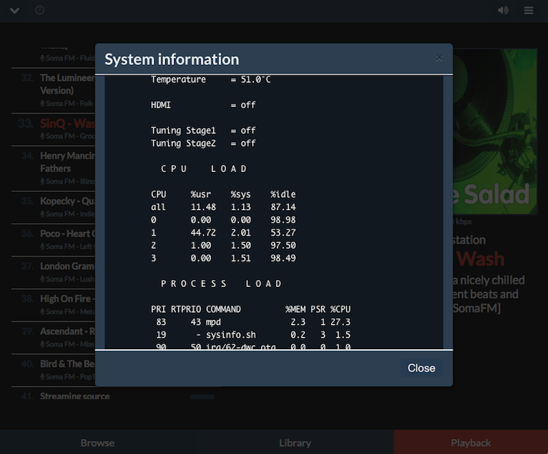

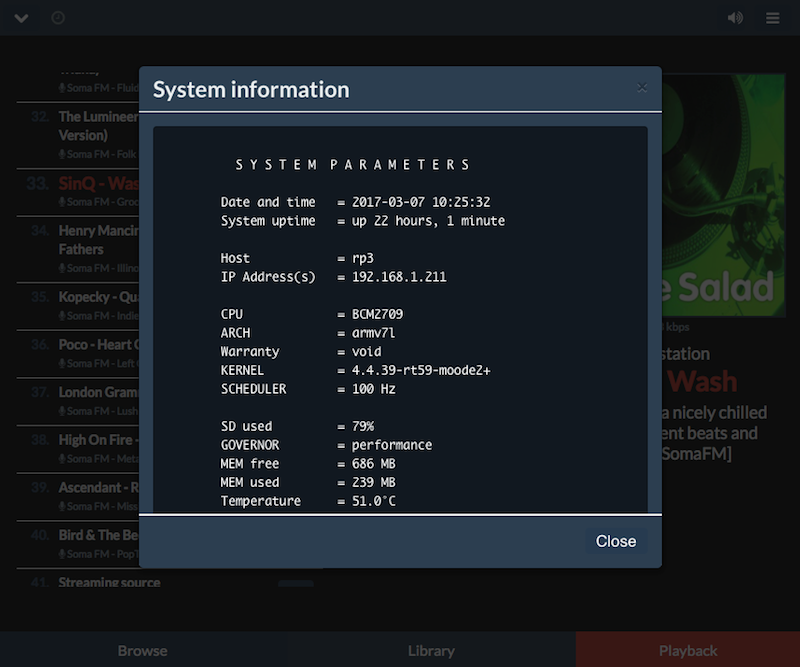

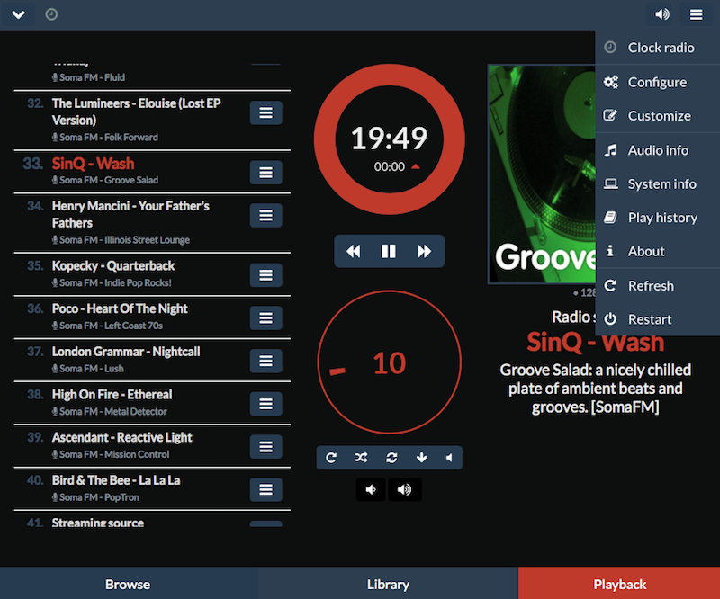

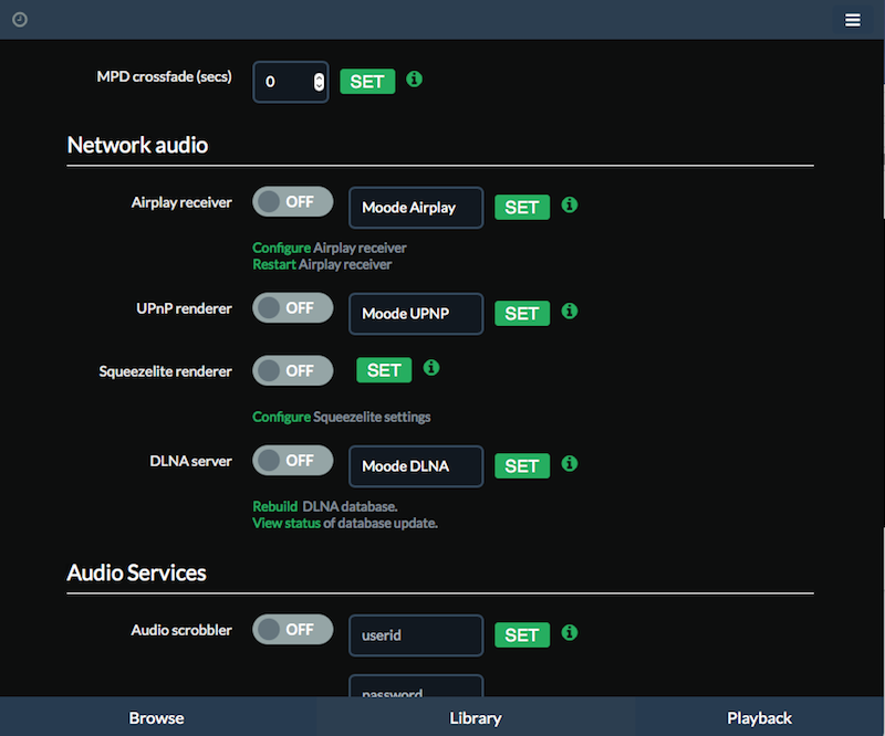

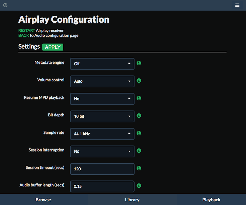

Some screen shots of two nice new features coming to Moode 3.5: Airplay 3.0 configs and System information. Thanks to MikeB for a fantastic shairport-sync 3.0 release and to inmate SC for a wonderful system info script.

@TimCurtis, this looks amazing, can't wait to try it!
