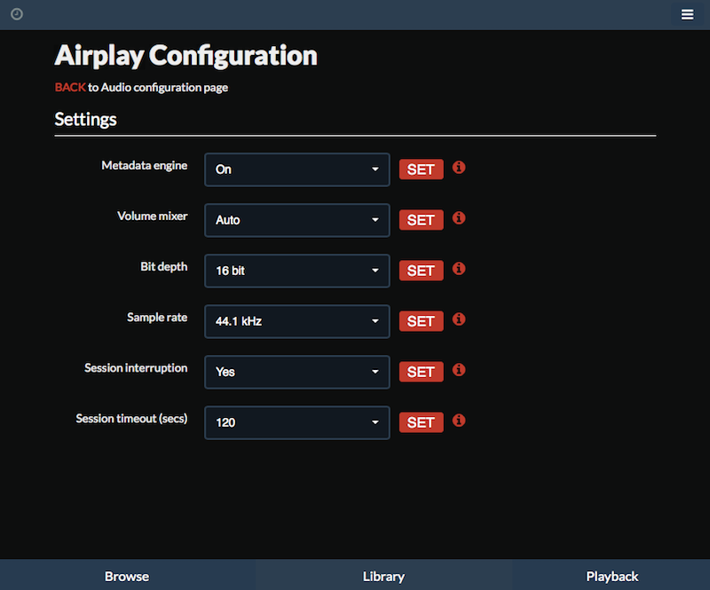

The new 3.0 version of shairport-sync offers some really nice settings so its getting a dedicate config page in Moode 3.5 🙂
