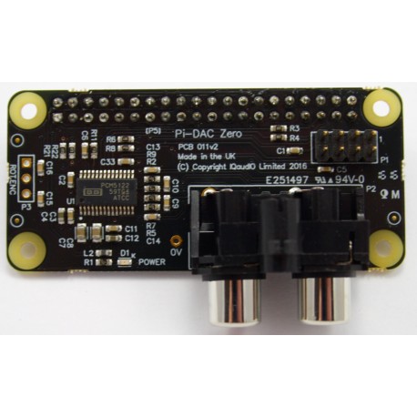

Grrr... the only place in the US with stock charges more for shipping than the board costs. Seriously, $12 to post a tiny box...
SparkFun charge less than that to ship a small box full of bits to SE Asia
You're going to have to wait until the less usurious outlets have stock.
It's not even a box. Pi zero doesn't have any. Just an esd bag, so it can go in the bubble envelope (that's how pimoroni.com sells them)
