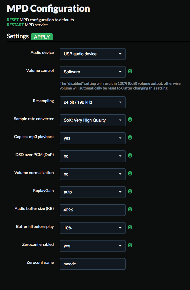

Best Settings for my DAC
I have been using Moode now for several weeks, and am really pleased with it.
However I feel that whilst the lower frequencies are well defined, the level is a bit low. I am using a first generation Meridian Explorer DAC. I have attached the settings I am using in MPD Config.
Perhaps these are not optimum for my DAC. Can anyone suggest the ideal settings for this DAC?
Thanks, Rob
Thanks, Rob
Can't help with your DAC, but I would try turning Replay Gain off and perhaps trying no resampling.
