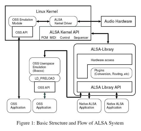

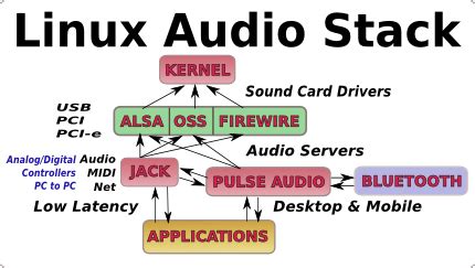

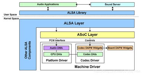

The purpose for the buffers is to prevent the audio from dropping out, it doesn't modify the frequency response in anyway. Think of the buffers as data buckets, the CPU will periodically keep topping up the buckets to keep them full. The contents of the buffers are simply pulled from storage media like an external disk drive or streaming site and then stored in RAM for the audio subsystem to access.
The CPU Governor has absolutely no interaction with the audio stack, the governor maintains the CPU frequency scaling to ensure the CPU is running optimally depending on system load, so it increases the frequency with a higher load and decreases the frequency on lighter loads. So its not possible by fiddling with the cpu scaler to modify the audio quality.
Changing these low level system parameters cannot possibly change the audio quality. I suggest reading about basic computing architectures before making unfounded statements about what parts of an operating system or a CPU can actually change the audio quality.
