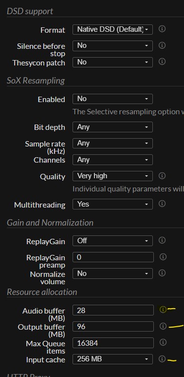

I have been a very happy user of Moode for my Raspberry Pi 4 since some time. Started with release 8.3.3 and a few days ago I upgraded to 9.3.4 from 9.2.4 and I felt that something wasn't right so I made a second SD with 9.2.4 to compare.
Sure, there is a quite big drop in sound quality with 9.3.4 compared to my previous 9.2.4
Can someone tell my why this is?
Are there earlier releases that the community say is better sounding than later releases?
Is it because of setup?

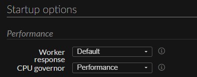

I have noticed that some settings of resource allocation in MPD have a huge impact on sound quality.
For 9.2.4 I have settled for these as the best sounding in my rig.
I noticed that a new version of MPD was used with the latest release.
Should I look for the change in sound quality because of a different MPD version ?
I really love the sound from my 9.2.4 so I will take great care to save that version.

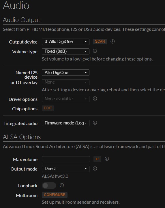

Using my Raspberry pi4 with Allo Digione and for DAC I use Mark Levinson No. 360s that sound fantastic with well recorded 24 bit 96kHz material.
I'm a bit concerned that the sound quality degraded and need some deeper insight from people with more and longer experience of using Moode.
Best version for the highest sound quality?
I set everything up for minimal processing, but have noticed that buffer sizes and input cache have a great impact on sound quality.
