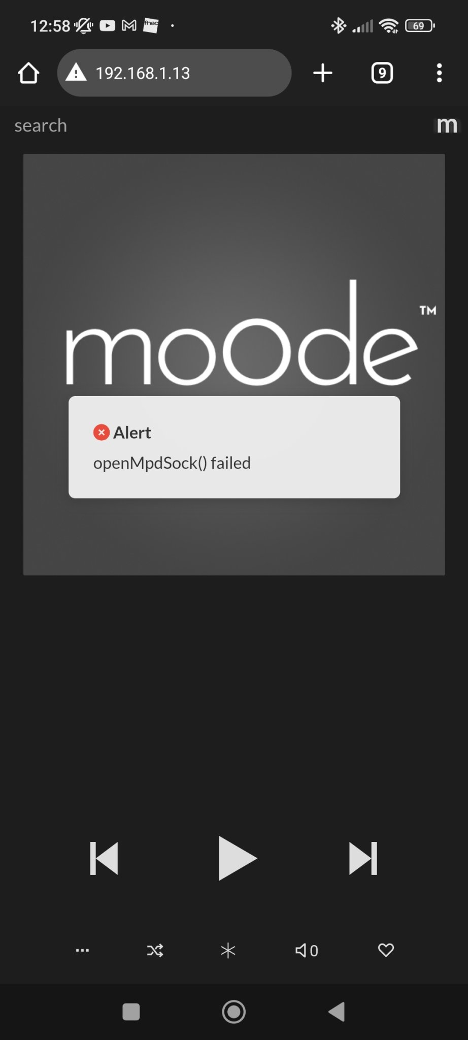

I tried with another micro sd card, it still crashed.
I'm going to receive a brand new micro sd tonight, we'll see.
info about my hardware
UGREEN Dongle Bluetooth 5.4
raspberry pi 3B+
dac pi es9023
deezer streaming platform
raspberry pi 3B+
dac pi es9023
Hi shinzuka,
I think it should be better if you post your issue on the moOde forum.
In the mean time you could try the base moOde functionality (try to listen some radio, the left/right test and some music from USB and/or network).

thanks I already know the other features and I use them regularly.
New subscriptions on the moode forum are closed. That's why I'm here.

I don't use Deezer yet. I'll try to replicate your problem, but I'm pretty sure it's not an SD issue. Have you tried another smartphone? As I understand it, Deezer features use the smartphone as a streamer - hopefully someone else will correct me if I'm wrong.

No, Deezer Connect turns the smartphone into a remote control. It does not stream audio to the moOde device, rather, it sends commands to the moOde device. Then the moOde device streams the actual audio.As I understand it, Deezer features use the smartphone as a streamer - hopefully someone else will correct me if I'm wrong.

@shinzuka : try to "Contact the Forum administrator to request an account. Be sure to include your preferred userid (at least 5 characters) in the Email message and an account will be promptly created." (Mail to: forum@moodeaudio.org or tim@moodeaudio.org).

Do you have anything with my username @gmail?
Pretty sure I've tried more than once to get an account and never heard back.

Nothing in the inbox with that name. I process account requests every day which suggests the inbox is ok.
Try sending another email and I'll check in little bit.
