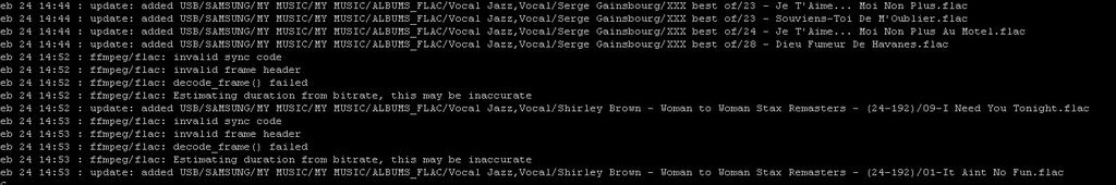

Here is the log, there is some error message but I really don't understand what does it meansI am really beginner !!!![]()
Can you understand anything from the photo ?
I can't even read it. Just paste some text from the log.

I am so sorry about it, you are right, very small, but I just take screen shots. well there is a list of albums and at the end this "Warning" as photo. I cropped it for bigger image.
Anyway after saw these files, I erased them for HDD and put raspberry again and re-start but this time, its updating endless again and when I try to take log again as you describe me, nothing on the log list. 😡😡😡
Sometimes the "updating spinner" does not get cleared even though MPD update finishes. Its a cosmetic bug that someday I'll get around to fixing.
The log clearly shows that files have been added to MPD index. Maybe try clearing your Browser cache and history, then refresh the page.

Really thanks Tim, really appriciate.
So it shows that all is ok, right ? But still when I entered the browse/usb/ it doesn't show me any folders or files. It is totally empty. An example, in my HDD, I put the albums by gender, blues, jazz, vocal jazz etc. and an example, when I want to listen vocal jazz, want to choose this sub folder from Browse/USB and choose play or add to playlist. But clndt do it because Browse/USB shows me nothing.

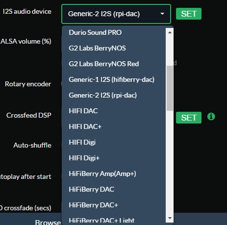

Having difficulty configuring a es9023 DAC. It works for generic DAC-2 but I would like to configure as generic DAC-4. Attached image is shows only generic DAC 1 and generic DAC 2 as available. Tried on both Rpi2 and Rpi3. Thanks in advance for any suggestions on how to get Generic-4 I2S (es9023-audio).

Go to System Config, install the advanced kernel and Generic-4 will become available.

Thanks for the suggestion "jonners". For some reason Advanced kernel isn't sticking. I reboot and it reverts back to standard. I select again, then can see the generic 4 DAC, reboot and it reverts back to standard kernel and generic DAC 2. Using a Suptronics HAT with es9023 (not x400).
Very odd.
Post output from cmd below.
cat /var/log/moode.log
-Tim
Output of cat /var/log/moode.log per Tim's request. Let me know if this is what you needed. Thanks.
energyman
Thanks for the great version 3.1
Isn't the Hifiberry DAC an i2s-connected es9023 chip? Could you try that?
