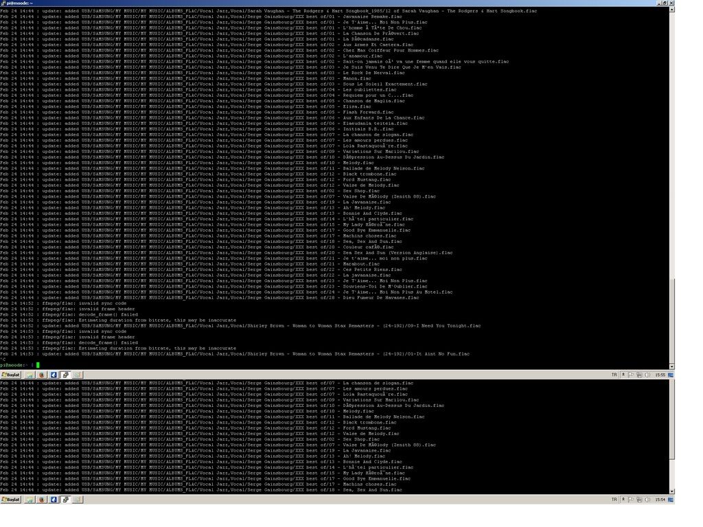

Hi guys,
I have problem that, when I put my HDD and Source/updateMPD, its updating endless, can see some of my files at Library but when I checked Browse/USB can not see any folder in USB.
Any chance to fix this problem ?
thanks in advance
- Moode System config, Clear system logs
- from ssh, tail -f /var/log/mpd/mpd.log
- Moode Source config, UPDATE MPD DB
- look for errors in the log
super huge embedded cover art images was an issue for one user
corrupt files have been an issue for many users
$RECYCLEBIN on a drive caused issues for another user
etc, etc
if you want more error information change mpd logging from "default" to "verbose" by editing /etc/mpd.conf then restarting MPD.

Thanks Tim,
Here is the log, there is some error message but I really don't understand what does it means
Can you understand anything from the photo ?
