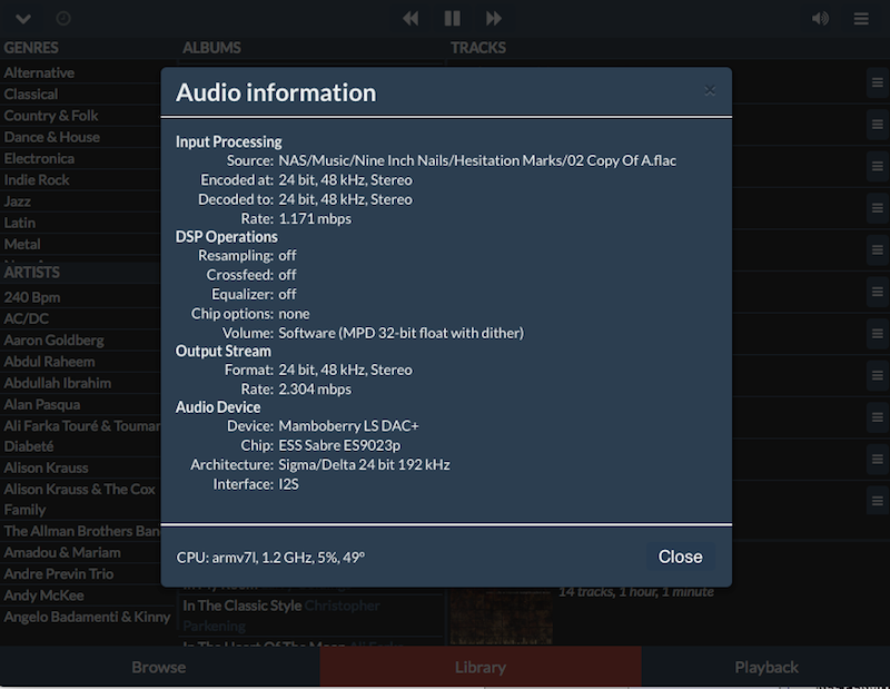

OK, that makes sense, but I'm still not sure why 24-bit audio (including 24-bit FLACs) is output at 32-bit.
The Digi+ is listed as having a "S/PDIF transceiver 24 bit 192 kHz" architecture, doesn't that imply 24-bit capability?
Thanks for your help!
Hard to say. The attached screen shot from one of my systems shows 24 bit FLAC through the audio pipeline. I used XLD to convert my ALAC collection to FLAC and the source track shown in the screen shot was originally 24/48 Redbook CD.

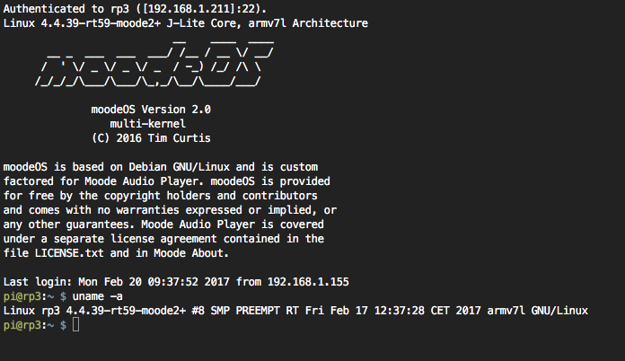

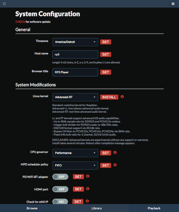

Next release of Moode will raise the bar for audio quality and include a fully integrated REAL-TIME Advanced Audio Kernel supporting the latest I2S drivers from Allo (Piano | Boss) and many other nice features and improvements.
Get ready for SMP PREEMPT RT 🙂
