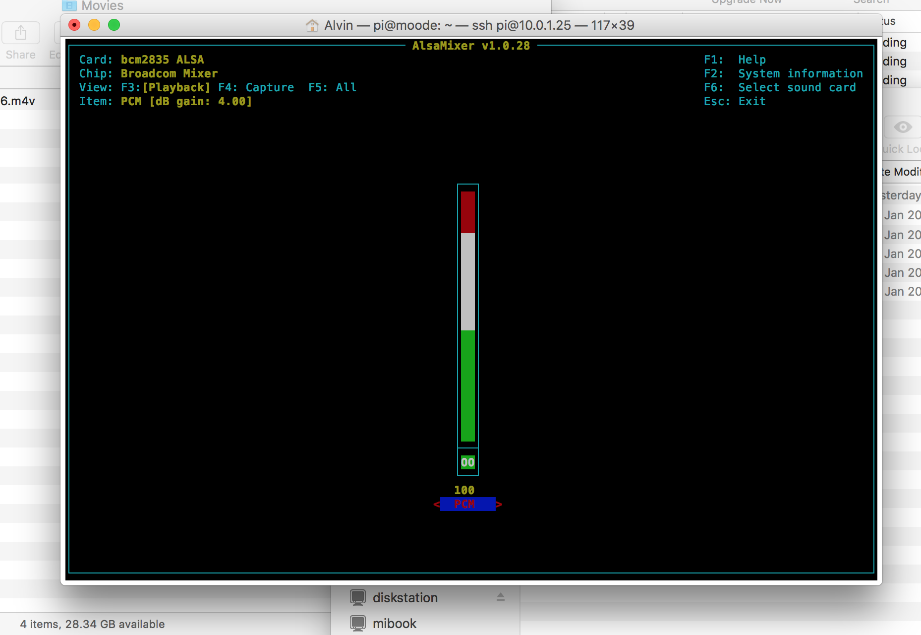

It does not seem to detect the USB connection. But when switched to Picore without touching any of the rest (just switching SD cards), it works. So, I don't think it is a hardware issue.
The log looks ok.
To troubleshoot:
- Type cmd: alsamixer and post a full screenshot
- Type cmd: amixer -c 1 and post output
I'll take a look
-Tim
The log looks ok.
To troubleshoot:
I'll take a look
-Tim
Hi Tim,
See attached screenshot.

I should have specified alsamixer -c 1 but in any case amixer cmd output looks ok.
I'm not seeing anything suspicious. Your DAC apparently has an on-board hardware volume controller. You could try setting MPD Volume control to Hardware, then in the Customize screen set Logarithmic curve to Yes.
Another option is to set MPD resampling to 32 bit / * kHz. Some newer USB DAC's have receiver chips that only accept 32 bit word length.
-Tim
