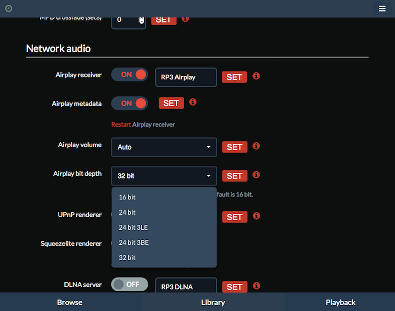

Integrating new v3.0 shairport-sync from MikeB. This is a really great release with a host of nice features including 24/32-bit output 🙂
-Tim

Wow, lots of cool new toys. What are the 24/3xx modes?

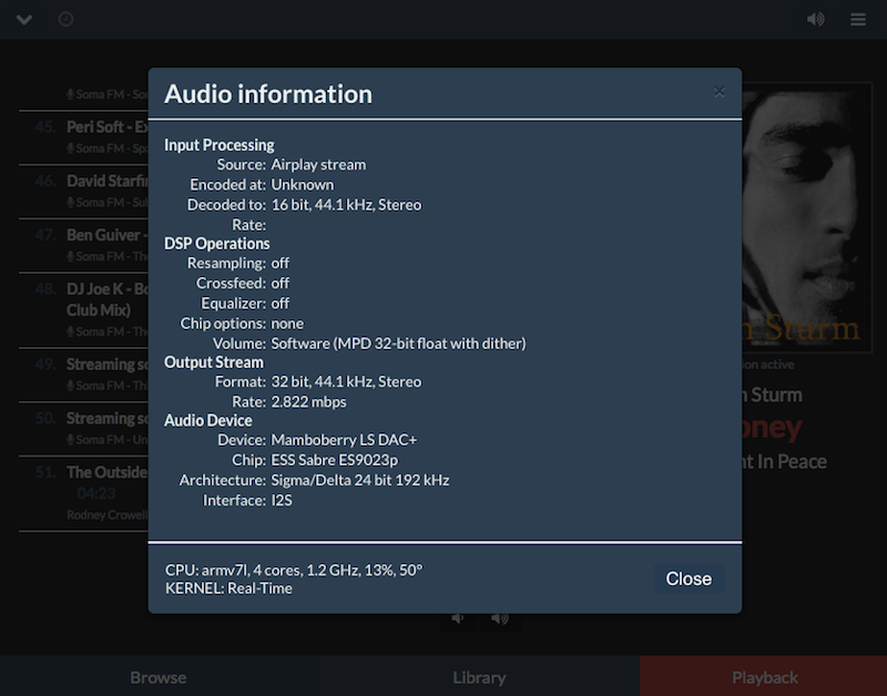

Hi Mike,
According to user reports, some USB DAC's only accept 32-bit samples for example Chord Mojo. https://github.com/mikebrady/shairport-sync/issues/463
Also, with shairport-sync 3.0 configured for 24 or 32 bit samples, its software volume control has a much lower noise floor. This is important if the audio device only supports Software volume for example any I2S board using ES90XX chips.
The really nice Mamboberry LS benefits from new shairport-sync 🙂
-Tim
