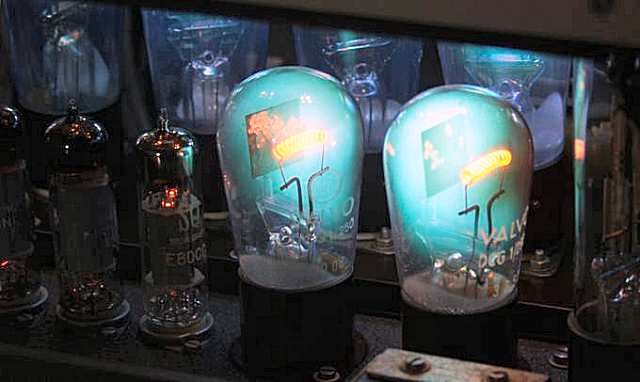

I don’t think that this 1000W amp shown on Utube is designed to power speakers. I don’t see a huge output transformer. I think that it is an RF amp or a modulator for a higher power transmitter.
3 phase is not commonly available for residential use in the United States, but there are some very rare exceptions usually for the extremely wealthy or connected. In the case where a house/mansion is large and I mean very large, (say 15 thousand sq ft and up) and geothermal groundwater heat pumps are employed for heating/cooling AND the local HV distribution is already 3 phase then sometimes the local power company may be persuaded to provide 208V 3 phase service at 400A and up. Where Tubelab lives that is definitely not the case. (I remember the last time this issue was discussed.) My neighborhood has 3 phase distribution, but I doubt anyone here has or can get actual 3 phase to their homes. My house is recently rewired/new service and has single phase 240V with neutral center tap. Everything major in my house (heat, hotwater, and stove) is gas so the only place I have 240V directly available is in my lab space and the garage - and even there I don't normally use it. I have 15A and 20A wall outlets, many on dedicated or modestly shared circuits.. (The 30A receptacles are hideously expensive/non-standard and I don't need them.)
Note Banat, there is no requirement here in the USA that any high current loads in a domestic situation be designed for 3 phase power, and the standard is not supported by any local power companies..
Again:Totaly strange to me that Electric Power Delivery system in USA,think the major reason for that system is personally people Safety issue determined with some USA federal LAW established long time ago.What is actually behind that regulation don`t know exactly- but think money(profit).Here in my country(Serbia) people can chose betwen two option for home electric power use.First is so called Monophase system- 1x 240v~ and second 3x400v~.Many people chose(over 50%) this 3 phase electric system for domestic use beacose even in smallest villages distribution system and all over the street and country is 3phase configured and many domestic electric aparatures too.But nothing is ideal even here mainly from three reason😛rices for 1kw/h is higher and higher every 6 monts,and if I goes with electric power consumption in so called `blue zone`or`red zone`prices for 1kw/h is more higher(penalty issue/again money),Second EPS(Electro Privreda Srbije) switched from old standard 3x380v~ to `new`European standard 3x400v~ and many old standard fabricated Electric Units(aparatures) don`t hold.Symple 220v electric bulb(solid fabricated) last for month or two maximum.Third -electric delivery Net is Old(special in small villages ) and total power breakdown is not rare,special during somer storm and winter rising electric consumption,but there is some advantages for tube high power RF(pirat)transmitter and high power tube audio. Good Luck
Yes that old Philps 1kw amp can run the speaker.Output transformer is hiden behind output tubes.But even RF modulator have this huge output transformer too(with diferent primary/secondary windings ratio and isolation issue).

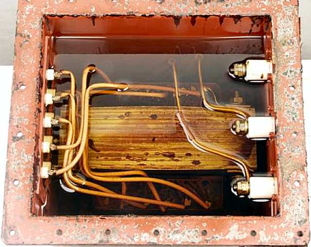

I have a small, probably stupid suggestion about cooling.
Put the amp in metal box, fill it up with mineral oil or liquid silicon, and pump it trough heat exchanger. Secondary system would circulate the water to take heat from oil. Use a cooling column of the type used in power plants. Secondary system can be placed away from primary. Immersing the whole amp in oil or liquid silicon will have four advantages:
- simplified lamp cooling design;
- better heat exchange between parts and coolant;
- electrical insulation (no water near electricity) and protection against shorts and accidental HV discharges;
- tank filled with oil would act as additional heat sink in case of pump malfunction. It will take some time to heat up coolant in the system to dangerous levels.
