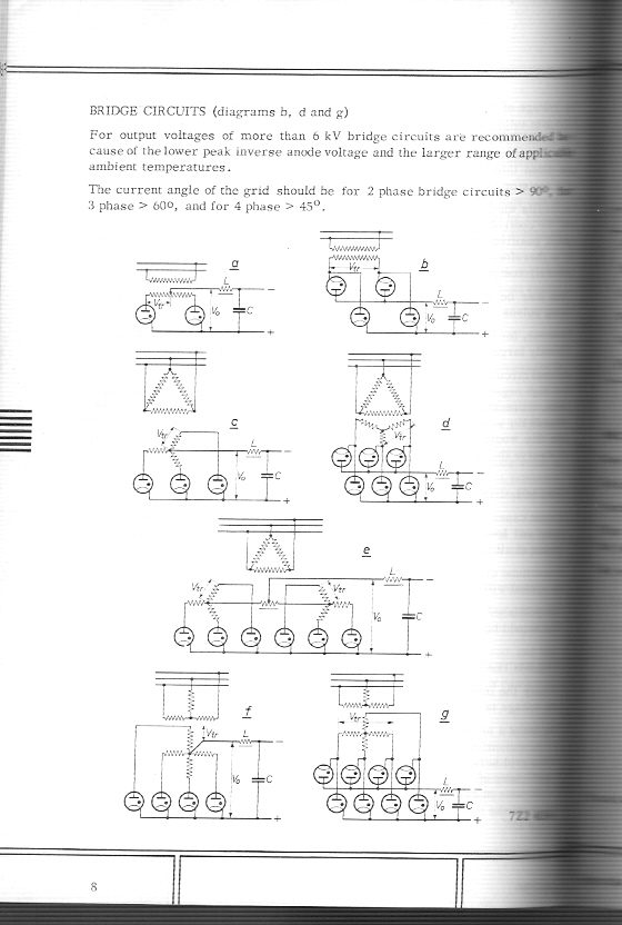

Here is the Philips basic suggestion from old Philips book about using the mercury rectifier tubes for different number of phases and voltage & power demands .
