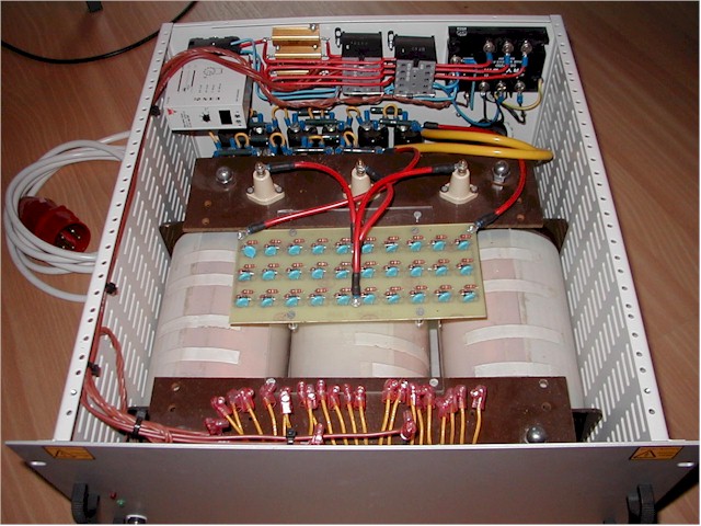

Attached photo of example PSU with single core, triple phase transformer mentioned earlier. Intended for amp with a tube with handles. Not audio though...
Tubelab: 7289 aka. 2C39BA on military steroids is not a good audio candidate, unless you want to water cool it. They are hard to cool efficiently using only air, even though they are specified for 100W dissipation. I wouldn't want an air cooled class A amp with those running near that limit. No idea if they are linear enough, just talking about cooling here.
Edit: Forgot to mention: 4CX250B and similar external anode tubes regularly flash over internally between anode and (screen) grid, whichever is closest to the anode. This is normal and expected. These flashovers need to be dealt with by combining overvoltage protection of the screen grid by discharging the energy to ground without destroying the screen grid bypass capacitor (where the grid in question isn't directly grounded).
Also, there is a limit to how much energy the PSU smoothing capacitance is allowed to dump into the tube during a flashover. Forget the limit in Joule for the small tubes, but the figure is somewhere in the Eimac literature. This is usually dealt with by simply placing a suitably (physically) large high wattage resistor in the B+ lead, something like 50 or 100 ohm/100W usually suffices. When the flash over happens, it appears as a dead short. The resistor now has the highest resistance in the circuit to ground (since you have overvoltage protection of the screen), and the full B+ happens across the resistor, leaving little energy for the internal spark. Thus it extinguish and normal service resumes. The resistor then needs to be able to hold off the full B+ for a short moment, thus the requirement for it to be physically large. It is usually chosen to be something like a glazed porcelain resistor or one made from a similar material.

More phases is fine for a motor, but a PITA for power factor correcting other loads.
Especially loads that would abuse so many phases to conduct only at the peaks.
For a given dc load current the rectifier current pulses are spread out over 3 times the effective area, individual rectifiers deliver approximately 1/3 the current as is the case with a single phase rectifier, and the peak currents scale the same way. You also get much less ripple voltage for a given input capacitance and load current. (Ripple frequency is also 3 times the single phase ripple frequency which makes it easier to filter. Smaller chokes and caps are possible for a given ripple voltage) I'd kill for 3 phase here and would run my bigger amps off of it in a heart beat.

Power factor has nothing to do with ease of removing ripple.
Its about narrow conduction angle problem seen by the utility.
What seems a convenience to you becomes a hassle for them.
I understand that, I believe it is the case that the effective conduction angle with 3 phase rectification (I'm specifically talking about the six diode Graetz bridge) is somewhat more benign than is the case for single phase for a given input capacitance and output load current. Star configuration provides much lower ripple voltage at the expense of much worse power factor than the Graetz. Better power factors in general can be achieved with choke input. Perhaps I am mistaken, but this was my understanding. It is clearly more efficient when large load currents are being dealt with hence its use with heavy loads. (And kitchen appliances in the EU.)
What would you do instead? Obviously when you look at the efficiency of single phase in high power applications it is clear that the 3 phase has lots of advantages in distribution.
Very large 3 phase switchers these days generally at least have the option to specify PF correction when ordered. The EU actually has quite specific PF requirements for mains connected devices, expressly so that the utility does not have to cope with extreme power factors, whether or not these are currently enforced I don't know.

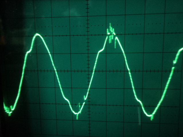

Also I am billed for poor power factor...seems hardly fair despite the poor quality waveform in the pic..... some farmer is using an electric cattle fence most likely incorrectly wired and spiking. The line distortion is very high too.

Wow that looks even worse than what comes out of my wall socket.. 😀

That looks like a disaster.😱 And you can amplify audio with that poor mains or are you playing on battery.
