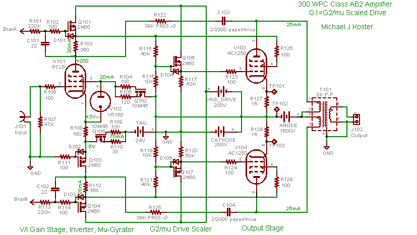

Here is a work in progress. I have a pair of 300W OPTs made by AES, supposedly from a Cary amplifier. They have 8K plate-plate impedance, and after a lot of deliberation this is how I am using them.
The 4CX250 and relatives have 250W anode dissipation and gm of >20 mA/V. Versions are available that use forced air cooling, water cooling, or conduction cooling, that I know of.
I found a small blower that can be operated at low speed which should be able to cool all 4 tubes up to about 150W anode dissipation each (at 300WPC output). Maybe it can have a simple thermal speed control. For me it's a decent tradeoff. The amp is in a fully enclosed chassis and the blower is down in the guts of it.
The relatively low g2/g1 mu of 5, and the decent grid power ratings make the 4CX250 a good candidate for scaled grid drive.
The asymmetric pentode/MOSFET LTP splitter with feedback loading is intended to use extra second harmonic in the driver to cancel some of the inherent third harmonic of the output stage, hopefully with tweaking to produce a nice waterfall with dominant 2nd. Scaled grid drive should be quite linear anyway.
