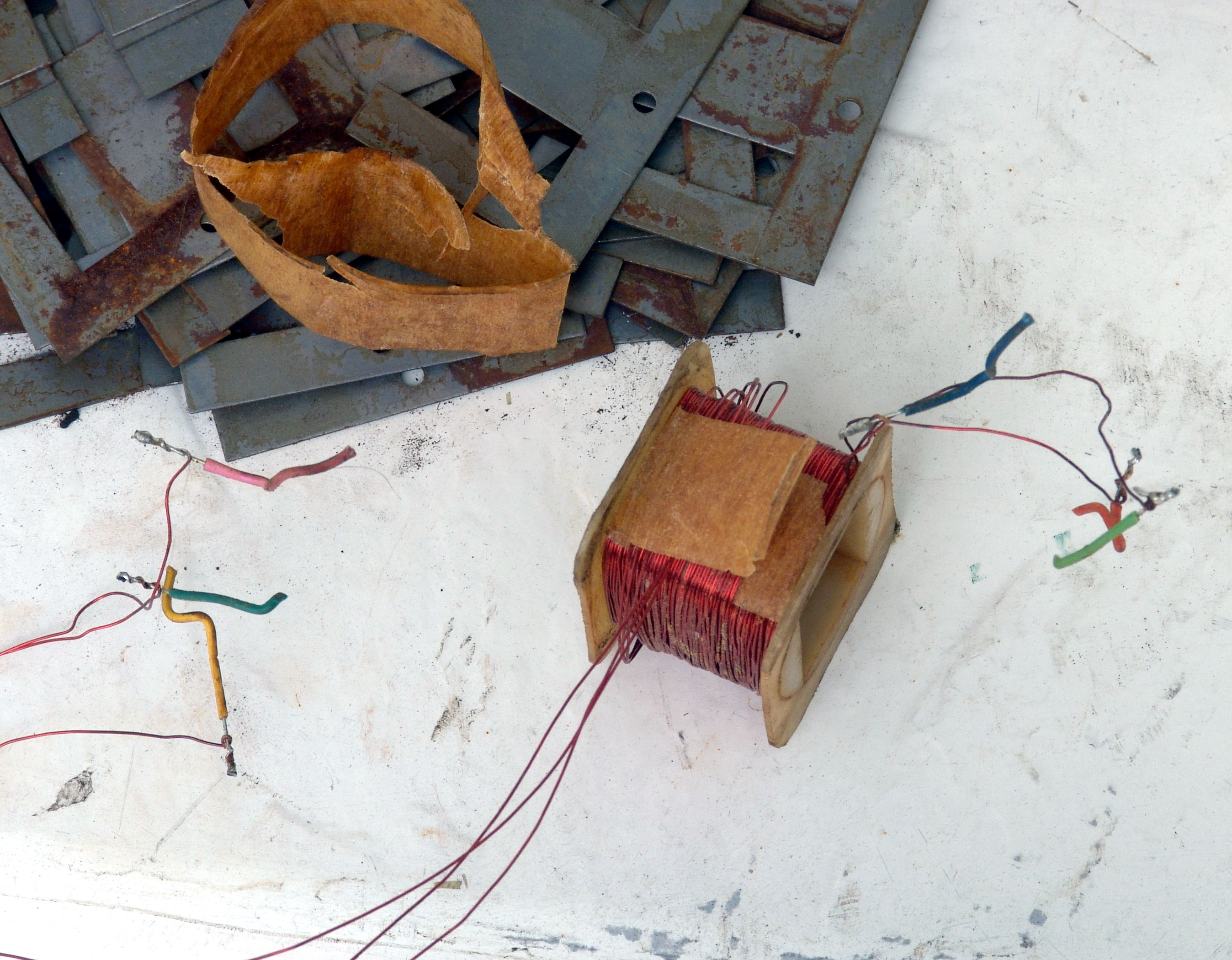

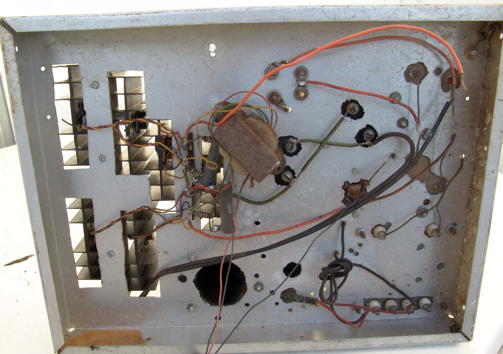

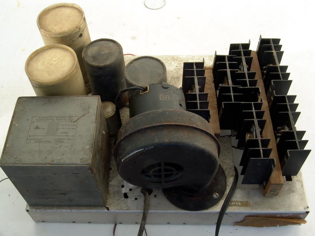

Well if we are to mention SS projects, I have been cleaning out my accumulation of "stuff" when I found some projects that I saved from way back in my past. I came upon this "booster amp" that I built in high school. It would have been late in 1969. Now understand that my construction skills sucked then, and my tools consisted of a hammer, a scrwedriver, a drill, and a nibbler tool. My budget was below zero so all of the components were obtained on barter. I traded my time for some parts. I knew that I needed a trifilar driver transformer, so I made my own. The circuit was patterned after the output stage of a Heathkit SS amp. There are 6 mystery transistors running on a B+ of 100 volts. We drove this with a small solid state amp and we were getting about 400 watts into a 2 ohm load. It was used for outdoor concerts and saw duty most weekends for about a year.
