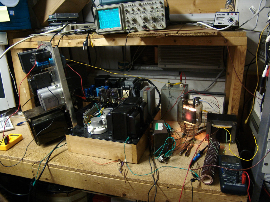

My experiments with the 833A in SE mode told me that finding an OPT for a mega-powered SE amp is unlikely. It also taught me about the heat buildup issue. So whatever I build will be P-P which means 4 tubes. With my current schedule and the backlog of unfinished projects, nothing is going to happen any time soon, but dreaming up new ideas doesn't cost anything......yet!
For those who are not familiar with those experiments, I'll enclose a couple of pictures. The first shows how I wired an 833A into my existing 845SE amp. The second is a close up of the 833A in action.
The 845SE amp was built on two chassis. The chassis in the back center of the picture is the power supply. It provided filament, driver power, and 1050 volts at 200 mA. That power supply proved inadequate to crank a single 833A into the red zone, so the chassis on the left was liberated from a surplus Motorola ambulance transmitter. It provides 1500 volts at 1/2 an amp. The power transformer weighs 75 pounds. I have 3 of these power supplies! The chassis in the front center is my 845SE amp. It was not modified, but I needed to run an external bias supply to feed the PowerDrive circuit some positive grid voltage. On the right is the 833A tube. Note the unorthodox connections made with vice grips and hose clamps. Like they say on Mythbusters, DONT TRY THIS AT HOME. During testing there was a 1/4 inch Lexan shield between me and the bench. It was removed for some photos. Of course a fire extinguisher was nearby!
The whole story is here:
The 833A SE Amp Prototype
