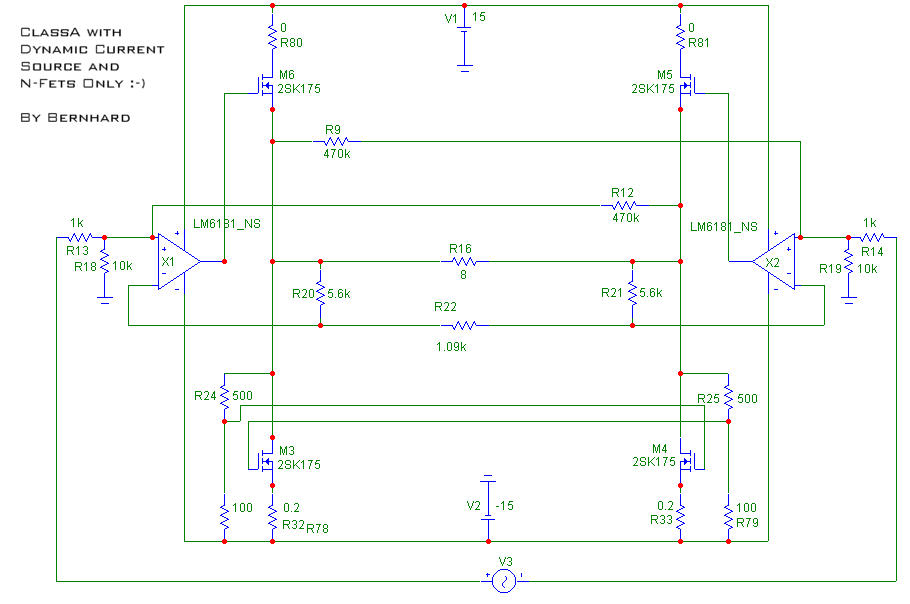

Single ended ?
When adding the classA-trick resistors to the op amps, driving the fets by the op amp rail currents and playing a little with values,
the whole thing becomes single ended. :xeye:
The currents through the lower op amp rails and the lower 0.22 ohm resistors are constant even @ full signal.
So the lower fets and the negative op rails act like constant current sources and the high side swings the signal :clown:
And this leads to madness again, until now I always tried to modulate the idle of a push pull, maybe with single ended and modulating the current source it is easier/better/aleph ?
But I don't like electrolytics...
I don't know if it is a problem that the currentvalues for the current sources are sensed from the other side.
If so, it should be possible to fix it.

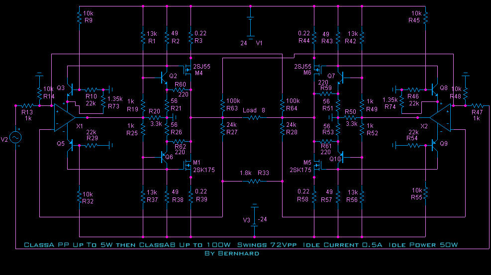

The circuit swings 40Vpp.

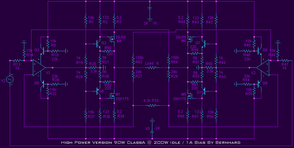

I have also the high power version of this one ready, which swings to 72Vpp.
The degree of current modulation can be adjusted by values.
Very nice, however you want to realize that the modulation
for the current sources is dependent on the output voltage,
not the output current, thus it is idealized for a particular
resistive load value, and will not work as well for other values
or reactive components. This is why the Aleph current source
was designed around output current - to make it more load
independent.

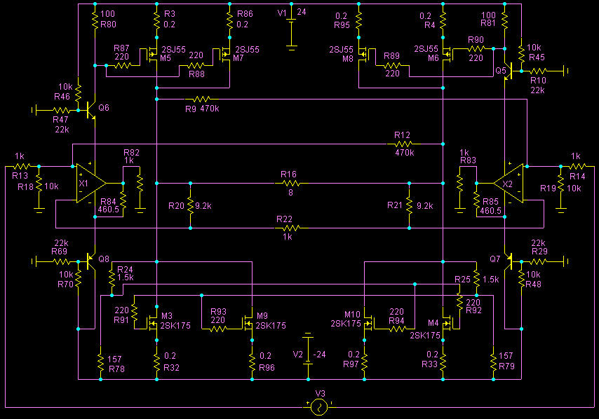

The resistor network can also be connected to the op amp output, instead to the amp output.
I have more variations in progress.
Bernhard

my madness amp behaves exactly like the basic circuit, so it is useless.
The madness idea led me to the above circuit that is single ended with dynamic current source, function is very similar with Aleph(X).
It saves 50% of wasted idle current in normal single ended classA.
The bad news for me is that with my 8 channels it is still far too much heat.

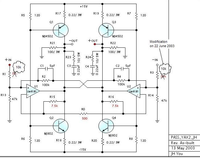

I have tried to lower the value of the input resistors, R1 and R3, mainly to earn more signal gain. I have reduced the value from 20k to 10k. The 10k gives me a signal gain of 17dB, offers 40V peak-to-peak output, provides a better current supply to the current boosters and shows square waves staying in the best range of stable forms. I have found that if I go further down, e.g. less than 10k, the square waves start turning worse. Therefore, the 10k is set as a minimum value.
This is to make myself possible to look for a set of low dB speakers. I am thinking to buy ATC A7 (8 ohm 84dB) or Audio Physic Yara (4 ohm 90 dB). I consider that one of these two could give me a happy near-field listening during my 3-year stay in Shanghai.
JH
