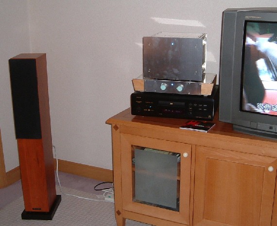

Yeah... Now I am an owner of the small and cute floor-standing speakers, Audio Physic Yara (2.5ways/ 4ohms/ 90dB). I am quite satisfied with them. Even if somewhat missing sharp definition at the bottom end frequencies, they are well balanced overall and good sounding speakers. Really impressed.
They go well with the power amplifier posted just above (Post#780) and BOSOZ.

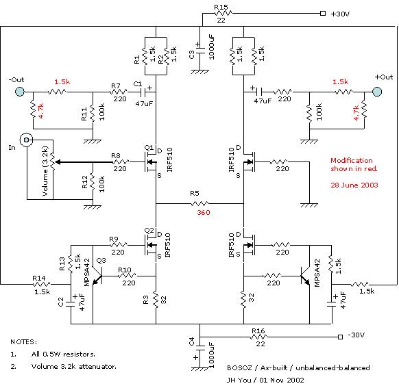

By the way, I have given some more variations to my BOSOZ. I have noticed that BOSOZ has provided better sound when R5 goes lower. I have tried to lower R5 down to 220, but the signal gain has been too much (with weak "sss..." noise from the tweeters). I have fixed my final value with 360, and, to control the signal gain and the "sss..." noise, installed output volume attenuators made with the resistors of 1.5K and 4.7k.

Hi jh6you
I am currently trying to build your design of BOSOZ with a +/- 50v rail.
But seems that for a +/- 50v rail, my resistor at R1/R2 is alittle under power. I am using a 3 watt resistor.
I don't know what are the various element that I should increase or reduce.
Hope if you are kind enough to give some pointers.

Hi CH2
In my circuit, 20mA is flowing through R3 (32 ohms) and accordingly 10mA through each R1 and R2. In this case, R1 and R2 of 0.5W or greater is okay with your +/- 50V supplies.
If you like to increase the 20mA to 30mA (or 40mA), you should reduce R3 from 32 to 22 ohms (or 16 ohms). Still R1 and R2 of 0.5W or greater is fine. I recommend 30mA (or 40mA) bias if you are going to have big enough size of heat sinks.

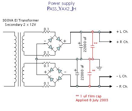

Updating:
I picked up two 2nd-hand Solen film caps of 1 uF wandering around and was just about to throw away them into the gabage box. No. they were still useful. I was looking around to keep them, but ... where? ... I couldn't find a proper place. What about keeping them inside the power amp? I picked up the solder too.
Yeah... they are quite effective for this amp. The top end frequency edges sound like being smoothed by a very fine sandpaper.
Hi CH2,
I'm very sorry for my mistake.
I hope you didn't follow my recommendation about the wattage of R1 and R2, particularly in case of the 40mA bias.
Right calculations are as follows:
For 20mA bias, power = 0.01^2*1500 = 0.15W across R1 and R2.
For 30mA, power = 0.015^2*1500 = 0.34W across R1 and R2.
For 40mA, power = 0.02^2*1500 = 0.6W across R1 and R2.
For 40mA, I recommend R1 and R2 @ min. 1W.

jiao liu yi xia (intercommunion)
jh4you:hi
Did you move your Monolithic SuperSymmetry with
Current Feedback amp to shanghai? because i saw chinese word
on tv in the picture you post. if so , maybe sometime you are free,
let us have a talk in shanghai , ok?

john-china said:
Jiao liu yi xia
Sure, we do (when I fairly settle down myself with this attractive new area).
The amp in the picture is the second one I completed to enjoy it here.
For your info, my place is Min Shi Yuan, Guang Yuan Xi Road, next to Jiao Tong University, in Xu Hui District.
