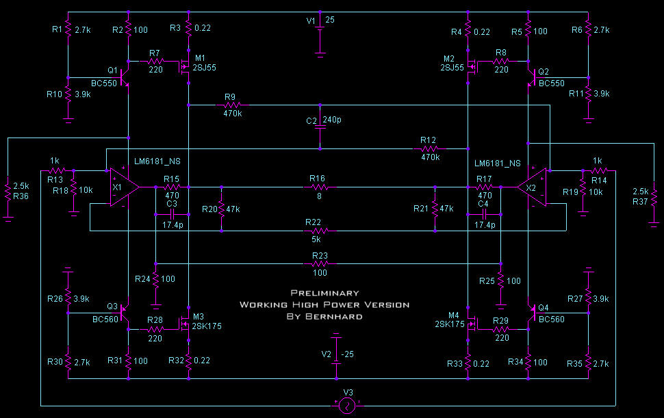

At first look, this circuit behaves like it should.
I'll try some AC analysis next.
The i(R3) and i(R32) plot look normal to me.
/Hugo 🙂

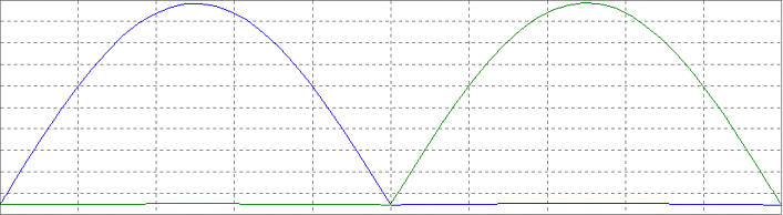

Did you get the jpg in the first mail ?
i(R3) goes below idle, down to 60mA, while i(R32) never goes below idle of 212mA.
IMHO it is not good for linearity if the Fets conduct less than 100mA current at any time.
The rails of the op amps behave both like i(R32), which means ok.
If you put a 5k between gate of 2sj55 and output, the problem is fixed more or less, but I would like to have a circuit without fixed problems and asymmetric... :nod:
This is real complicated.
Isn't it better to do the - I call it " current lifting " now - on both halfwaves, because if it is done only on the halfwave where the Fet can not conduct current, (to keep the current flowing and let the Fet remain in linear mode), the feedback will have to add current on the other side's other halfwave to keep the signal as it should be.
Can you follow me ? :devily:
Maybe the sound will be better if the feedback does not have to tweak so much on the waveforms. 🙂

Bernhard, try other mosfets.
I tried the irfp9240 and the irf240 and the idle current is perfectly the same at both positive and negative side but the circuit tends to oscillate slightly.
There must be better pairs. Look what Nelson uses as p and n-mos pairs.
I would use less feedback too.
Also, in your model program, with your circuit loaded, when you click on the icon left from the text icon, the "pin connection" icon, you will see all the nodes displayed. Some wires are too long and tend to make faulty connections. Drag M4 away for example and you will see what I mean.
/Hugo 😉

I tried the irfp9240 and the irf240 and the idle current is perfectly the same at both positive and negative side I would use less feedback too.
Hugo,
did you keep the other values, when changing to irfp ?
I tried that and it gives me no idle at all.
Yes it looks perfectly in the transient analysis, except the crossover distortion :dead: but with no idle, no wonder...
When You change R2 and corresponding to 560 ohm idle will be about 220mA and the currents through the 0.22 ohm will look even worse with irfp, compared to 2sj/2sk.
Just sides have changed.
One stays at idle and the other really goes down to nothing :bawling:
Or did I miss something ?
You’re correct, my mistake.
When changing R2 and others to 560ohm the whole circuit dissipated 300W :bigeyes:
So playing with those resistors will bring the solution.
At 200ohm for R2/R5 and 120ohm for R31/R34 there is a nice idle current of 300mA at both sides.
The fact that those resistors are different in value is due to the use of p and n-mos types IMO.
Not to confuse you, but maybe the difference has something to do with the wiring and components on the negative input of the opamps.
Didn't play with those, so I'm just guessing.
/Hugo
:nod: I found the door.
For the basic high power circuit.
Guess what I did !
It is not fine art, but it works... 😎

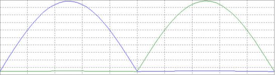

This is my working amp, with two 2.5kohm resistors added to make the currents trough the 0.22ohm Rs symmetric.
Also added the 17.4pF Cs to make the amp stable, and last but not least the 240pF C to get a nice square @ 100kHz.
It may be possible to connect the op amp outputs to ground and leave out the parts that are now connected to the op amp outputs.
But will the amp remain stable ?
In the end the madness circuit gives the same current waveform like the normal version, so I will forget about it.
It was a try and not for nothing because I learned a lot...
Netlist said:
The wiring of R36 and R37 are different.
I assume R36 is correct.
I would say: time to heat the iron!
Netlist,
yes, I redraw the schematic without testing afterwards :dead:
The other possibility that is left over is to make it classA pushpull and switch the bias via relais in 6 or 10 steps.
