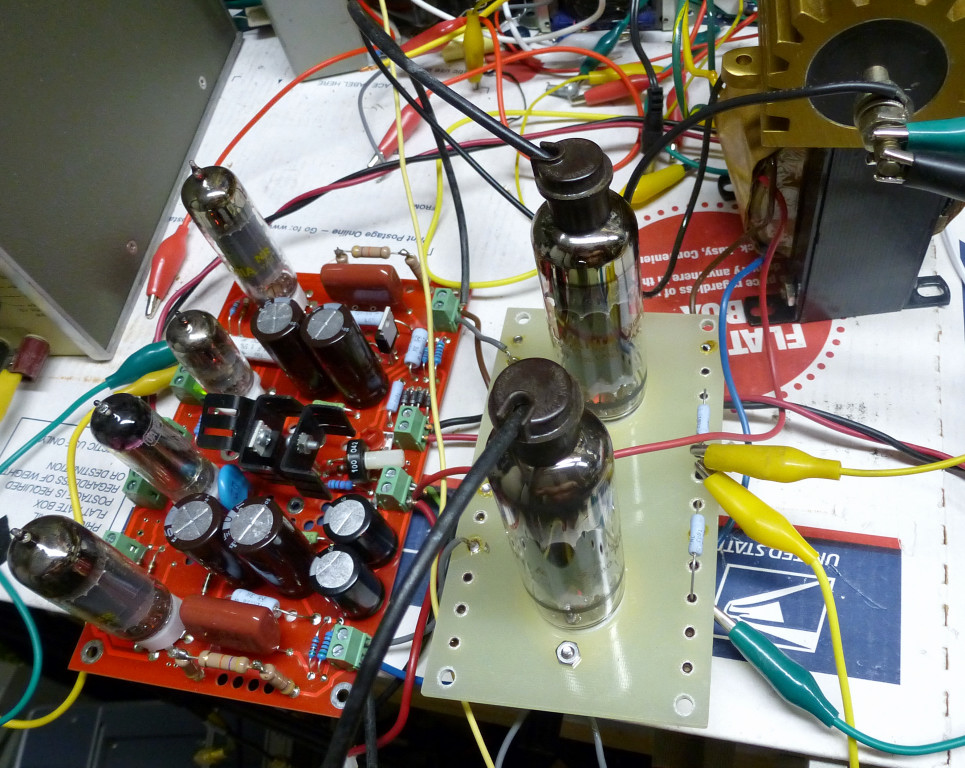

Something has been missing from my life.......I have been busy with life's little things like going to work to pay the bills....and even some fun things like going to Seattle to see my grandkids.....but there has been no glow, no smoke, damn, the soldering iron hasn't been turned on in....I don't even remember.
Somehow I managed to get this week off of work. We still have "stuff" scattered all over the house since cleaning out the warehouse. The plan was to spend the week sorting and organizing some of the "stuff" and listing some of it on Ebay, but my ADHD took control of my brain and then it happened......
I just needed to see some glow....even if I just connected some junk tubes up to a power supply and fried the life out of them.....it had to be done. Before I could connect the clip leads up to the power supply.....zap ADHD had planted another thought.
Last February I built two of these boards. I lit one of them up and extracted about 10 watts out of it WITHOUT any output tubes. That was post #36.....the board has been sitting on a shelf ever since. Well, I have a working driver board, a bunch of power supplies, some turret boards for several flavors of tubes, and lots of tubes, so maybe it's time to turn on that soldering iron......
Damn, it doesn't work. That's right, Tubelab doesn't even have a working soldering iron, NOOOOOOOO. I know there is another one here somewhere.....but where. I spent about an hour looking for it last night, then another hour this morning, so time for a brain shock......I jump in the cold swimming pool!!!!! 5 minutes later I am opening a box that contains a brand new soldering iron I bought a couple of years ago because the tip was stuck in my 15 year old iron.
OK, I have an iron, boards, power supplies, tubes, and all the other stuff I need.....Now, which tubes do I FRY.....no I mean "test". I have a credit at two tube stores since I have been selling off my tube collection, so how about one that is on the dollar menu......Then I remembered this:

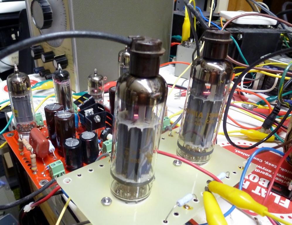

I am considering a build using $1 13GB5's as output tubes and a 1200 ohm plate to plate impedance output transformer
Well, I got 10 of them, they are on the dollar menu, so easy choice.....hook em up.....light em up.....Damn these little tubes CRANK!......Like how much power does it take to make these things GLOW.......50 watts......no too easy.....do I hear 100......NO GLOW YET.....CRANKKKKK.... a pair of these little guys can crank out 150 WATTS and just begin to show glow. Thats 150 W RMS at 3% distortion! Full cranked square waves read 190 Watts on the HP8903, but that's not really accurate.
I stopped twisting the dial at 600 volts because the last time I dimed the power supply into one of Pete's red boards there was a rather BIG BANG and a capacitor vanished. I don't remember exactly what voltage caps are in this board.....
So the details.....Load impedance is 3300 ohms. I am running a 6600 ohm OPT with a big fat 8.02 ohm Dale 120 watt resistor across the 16 ohm tap. Same setup I use with the big sweep tubes in Pete's big red board. The bias was adjusted for 35 mA per tube, and the screen voltage was set to 175 volts. I tested the setup at plate voltages from 300 volts to 600 volts. The same B+ supply was fed to the driver board and the output tubes. A second supply runs the output screens at 175 volts, and a third provides -80 volts to the red board.
I set the B+, set the bias to 35mA and cranked the signal generator until the audio analyzer read 3% THD, and pressed the power output button.
300 Volts 30 Watts
350 Volts 56 Watts
400 Volts 72 Watts
450 Volts 91 Watts
500 Volts 106 Watts
550 Volts 125 Watts
600 Volts 152 Watts
Don't know how they will work at 1200 ohms, but I suspect that's too low. I was surprised to see thay they liked 3300, most tubes this size don't like much below 5000. I have a way to do 2500 and 1250 ohms, but it involves finding an OPT that I haven't seen in at least a year.

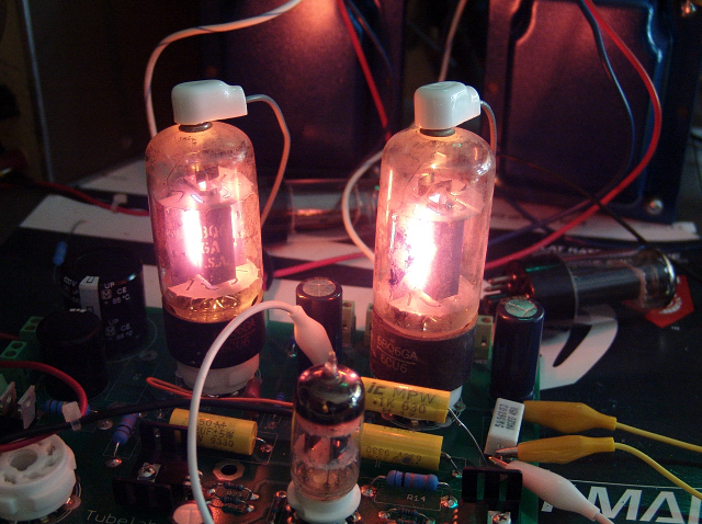

The 13GB5's cost me $1 each.....I was nice to those. I bought a BIG box full of 6BQ6GA's a few years ago for an average cost of about 35 cents each. This was the ugliest pair in the box, I CRANKED them a wee bit too far!
mind you the combined plate and screen is 22 watts...
I figure that they were dissipating about 25 to 27 watts each at full crank. Most of that was plate dissipation. The screen current drops as you increase the plate voltage. Things didn't start heating up until I went past 500 volts.

...it will be interesting to see how low the B+ needs to be for these NOT to blow up with 1250 ohms load...
I hooked up the big Plitron OPT and tested with 1250 ohms and 2500 ohms. I was surprised to see excelent results at 2500 ohms, but the tubes aren't too happy with a 1250 ohm load.
The distortion at low power (about 5 watts) was about 2% in yesterdays testing at 3300 ohms. I made no attempt to reduce this, or even figure out why. I just turned up the idle current until the crossover notch went away, then increased it until the distortion stopped decreasing, the result was about 35 mA.
Today I removed the guitar amp OPT and connected up the big Plitron set for 2500 ohms. No other changes. The baseline distortion was 1.1%. OK, it IS a much better OPT. The power readings are at the point where the distortion increased to 3%. The data:
300 Volts 56 Watts
350 Volts 76 Watts
400 Volts 98 Watts
450 Volts 121 Watts
500 Volts 136 Watts ..... pale glow in a dark room
Then I changed the secondary tap to reflect 1250 ohms. These OPT's ARE rated for 1250 ohms at 400 watts. The baseline distortion was over 3%. Increasing the idle current to 45 mA brought it down to 2.1% so I left it at 45 mA. The data:
300 Volts 41 Watts
350 Volts 54 Watts
400 Volts 67 Watts
450 Volts 75 Watts ..... big red glow in a brightly lit room
Since the distortion started out at 2.1% it doesn't take much to hit 3%. More bias current didn't help much. I have been using output tube plate to driver tube plate feedback in all tests. Same concept as in the big red board. The resistor was arbitrarilly set at 141K ohms (3 X 47K in series). I did not try a different value.
How would you suspect the data would change if you lowered the screen volts on the 1250 ohm test?
There's only one real way to find out, and it only involves turning a knob.......Turning the knob down makes things much worse, so.....I turned it the other way. With the plate voltage at 350, the screen at 200 and one of the feedback resistors jumpered so the total value is 94K (I am using 6HB6 drivers with a lowish plate resistance) there are now signs of life. baseline distortion is 1.4% and cranking the drive until I see 3% results in 94 WATTS, which coincides with the onset of pale glow in a dark room.

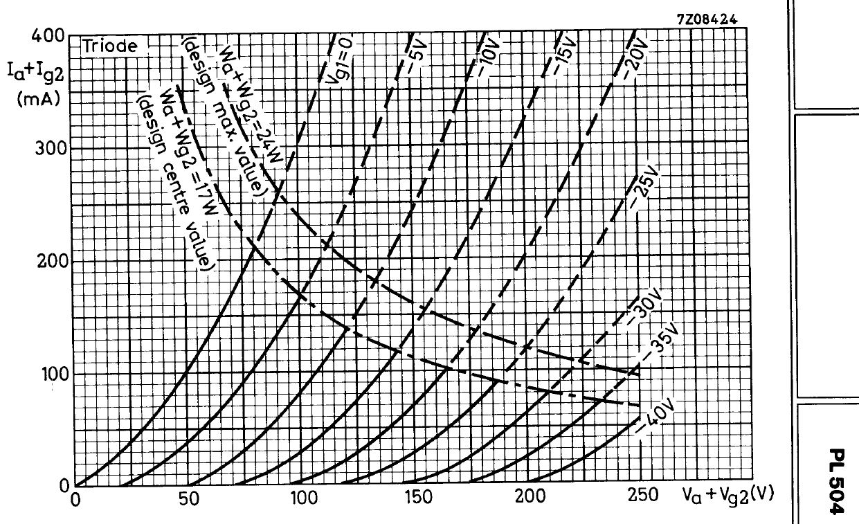

Care to hook up the 13GB5's as triodes?
You really want me to blow these guys up don't you. My previous experiences with sweep tubes in triode usually resulted in dead tubes...except for the 6AV5's. Oh, well I got 150 more of them on the way!

However, this is one of the few sweep tubes I have seen with triode curves, hopefully this will further the cause...
