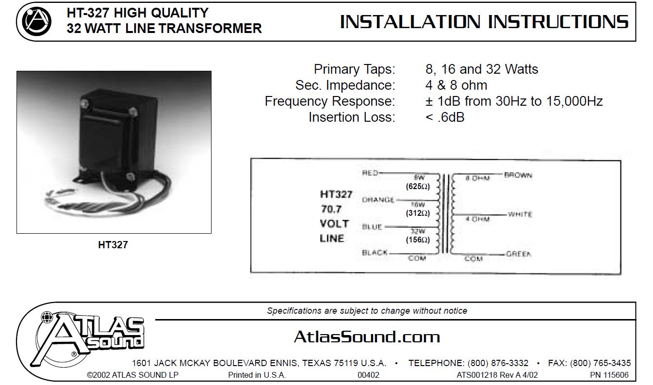

First off, here are the output transformers I plan to use in a 13GB5 triode strapped amp: 70.7 VOLT-4,8 ohm LINE TRANSFORMER 4 lbs. Buy It Now $16.00 172812 HT-327 | eBay
The seller will negotiate for large purchases. I (stupidly?) bought several of these to play with. Specs are attached. Why this transformer? With 8 ohms on the 4 ohm tap will be 1250 ohm primary. Also dirt cheap in keeping with the 13GB5 price.

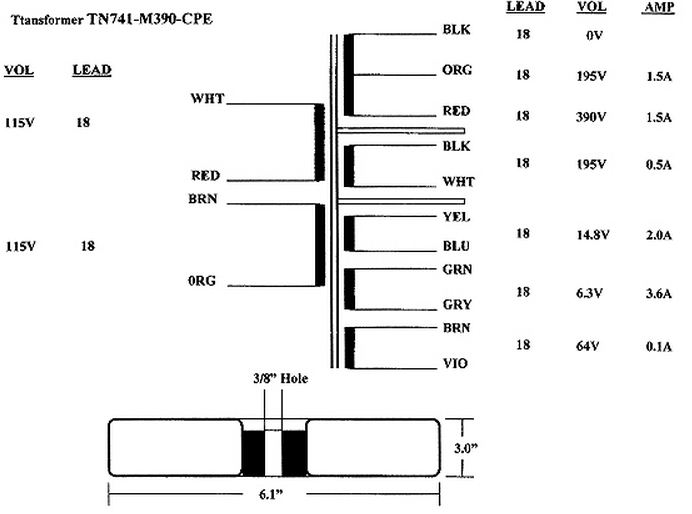

I looked for a power transformer with the "proper" low voltage for the B+ and found one that should also do duty for the 13GB5 filaments, etc, pic attached. Hard to find a transformer that yields less than 300 VDC. 240VAC secondaries are easy to find but yield way over 300 VDC.
I should be able to "overload" the 14.8 vac at 2 amp winding with 4 parallel 13GB5's drawing a total of 2.4 amps.
The 390 VCT should yield about 260 VDC or so. If you put a FWB on it, you'd get over 500 VDC so this trans should be useful for other builds.
I'll run a voltage doubler on the 195 VAC winding for the phase inverter and of course the 64 VAC for bias.

The 70 volt line transformer you are planning isn't listed on Ebay right now (listing expired). My experience with line transformers as OPT's has been hit or miss. Many do not heve enough inductance to handle bass. They are designed to be driven from a low impedance constant voltage source. Triode tubes with plate to plate feedback may be the best bet. Remember that the blue wire is the CT, not orange.

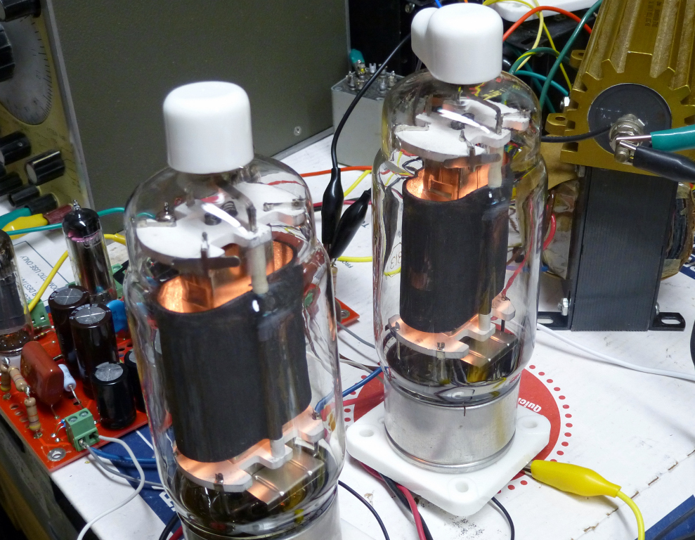

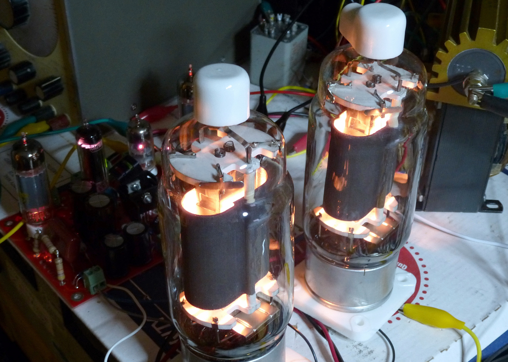

I want a 813 amp now. It's not about power, it's just that gorgeous looking tube.

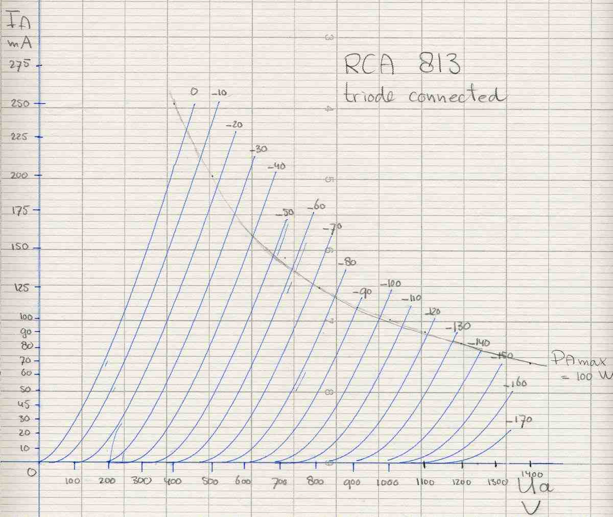

Good thing it's not about power.....cause you aren't going to get much. I Googled a bit and everything I read said you need at least 850 volts to get these tubes going, and thats in triode, you need over 1000 in pentode.
My biggest power supply only goes to 650 volts, and I had it maxed. I was getting 35 watts in triode with all feedback removed. Clipping set in when the capacitively coupled driver attempted to drive the 813's grid positive. That big grid is like a clamp diode across the output of the driver. What we need here is a mosfet driver and some more voltage.....lots more voltage.
Well at least it looks cool, and lights up the room.

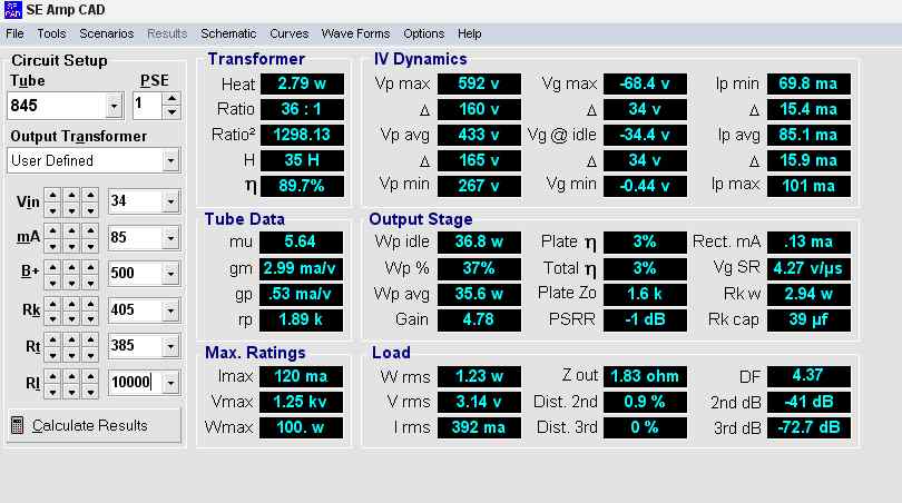

I'm going to sim the circuit in SE CAD and report back. Thanks for the info.
Damn, that tube is not in the library. OK, this is Pete's place anyway soooooooo..... this is my last interruption to an otherwise nice thread.
Just for giggles I did it with the 845. Look at those numbers..... lovely, aren't they? Too bad it's only one watt haha, that wouldn't stop me though what stops me is the fact that I'm not in love with the 845. 813 is my babe. I will build it even if it ends up being a super Champ. See ya.

Maybe 8 years ago I got that simulator. I plugged in 845, 5K load, A2 with as much drive as the tube can eat, and 1100 volts of B+. SE cad said 42 watts of power, which nobody including me believed. I built it and the simulator was right, I get 42 watts.
