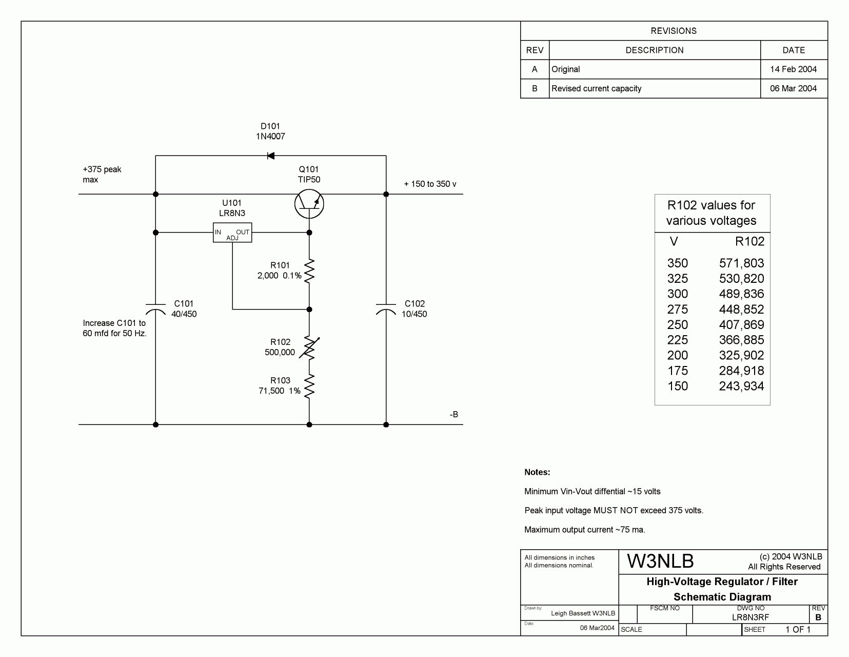

The LR8 circuit below I have used before with a preamp power supply.
However, I would like some gas tube glow.
The bias circuit should be fine with a simple gas tube shunt circuit (substitute for zener below).
Has anyone used a transistor as pass element in a gas tube referenced supply (i.e. substitute a gas tube for the zener)?

Any particular regulator circuits you like?
I have seen plenty of rather complicated closed loop regulators, and I may indeed experiment along those lines, but I have been using a rather simple circuit known as a capacitance multiplier since the 1960's.
A closed loop regulator like the Maida must be well designed to avoid instability when connected to a capacitive load, and supplying a varying current load like a class AB amp. It can and has been done, and is the right choice for a plate supply due to its low output impedance.
I am interested in regulating the screen and bias supplies. A very low output impedance is not needed, neither is .01% regulation. What we need is a stable source with good regulation that can't be driven into convulsions when the Big Dumb Blonde One plugs in his guitar and drives the amp about 20 db beyond clipping. 🙂

I plan to use a circuit similar to the screen regulator in Pete's big red board. It is Q1 and the associated components. Pete added R1 to lower the dissipation in the mosfet. Do not eliminate this resistor (a lower value is OK). It is needed for peak current limiting at turn on, otherwise the surge can blow the mosfet. The regulation can be improved by replacing R33 with a CCS. This removes output voltage variation caused by the zener impedance. Using a film cap in place of, or in parallel with C22 improves the high frequency noise. So can another (RC) pole of filtering in series with R46. D6 can be omitted if your mosfet has built in gate zeners.
For the bias supply I plan to use the same circuit with all the caps and diodes turned around and a P channel mosfet.
I have used a VR tube in the same circuit described above (Petes circuit used for example).
Do not put a large value cap directly across the VR tube, that will make a relaxation oscillator. I use a .01 uf cap. C22 in Petes drawing.
Several VR tubes can be wired in series for the required voltage, and you can tap off of each one with its own follower. As before a CCS will improve the regulation.
I prefer a mosfet or vacuum tube follower. A mosfet provides the best regulation due to its high Gm. A vacuum tube has glow appeal, and is generally more forgiving of accidental short circuits that tend to rearange the molecular structure of silicon devices. I avoid BJT's in circuits that draw a varying current, because they draw base current proportional to the load current. This affects the current through the zener / VR tube string, which also affects regulation.
