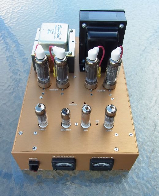

Finally posted details about the PPP 807 amp (using this driver) on the web page. Still a few things missing (like a BOM) but most of the info is there:
"807" Push-Pull amp
"807" Push-Pull amp

I suppose I have one question.. Should the 10m45's be hot? As in, turn the amp off, let it discharge for a few minutes, and I still can't touch the heatsink for more than a second. Someone else has my IR thermometer right now, so I can't be more precise than that...
what i do in this case is to add a series resistor so that the power dissipated by the 10m45's can be shared with the power resistor....

Pete, being all too generous, loaned me his new amps for a while so I've taken some measurements for you. He's using the 120 V tap (brown wire on the classic tone) and my line is at 121.6 v right now. Heaters are at 6.5 v. I calculate that on the 100 v tap this would give 7.8 on the heaters. Sounds like you're right on with the 7.5 you're measuring.
