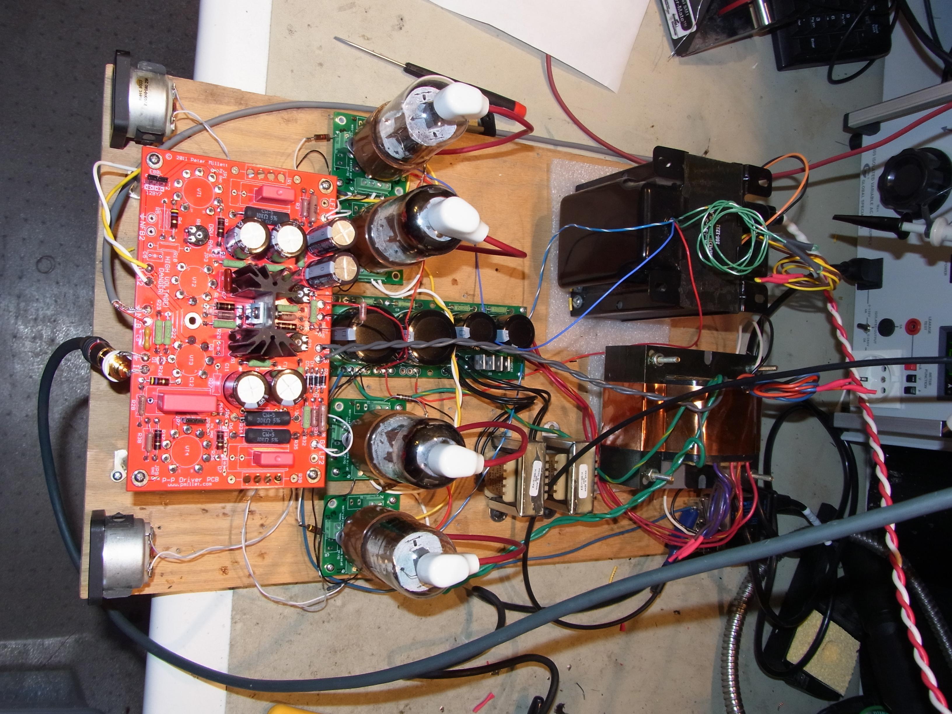

PPP 807s
Hooked up parallel 807's (actually 807W/5933) on the breadboard.
Same driver as the KT88, with a little tweak to the bias circuit to lower the voltage. No effort to match the 807's, they aren't even the same brand. Tubes are directly paralleled (no separate bias).
Vp = 559V, Vg2 = 279V, Vg1 = -32V, Ik = 40mA/side or 20mA/tube, Pa = 11W per tube at idle.
1W THD = 0.03%, 12W THD = 0.20%, 5% THD @ 25.3V or 80W RMS into 8 ohms.
Square wave looks good but the amp oscillates with no load. May just need to put 100 ohms across the output, or maybe a screen bypass... needs investigation.

Played with the compensation to get the amp stable under no load/full load conditions. With no load, it was oscillating at 1MHz + 10Hz!
I needed to add another RC (1k & 470p, C9 & R27) on the first stage, change the feedback comp cap from 47p to 68p to kill the HF oscillation and properly damp the square wave response. Also increased the coupling caps to 1uF (first stage) and 0.22uF (output) to avoid the LF oscillation. This also reduced or eliminated the LF and HF response peaks I saw earlier. Its pretty flat now from 5Hz to 50kHz, but still has a 1dB peak at 75kHz.
Also added a 150 ohm 5W resistor across the output. Seems pretty stable now, at least with a resistive load from 4 ohms to open. Zout is 0.57 ohms (DF = 14).
If I increase the idle current up to 63mA/side (still only 18W/tube), 1W THD drops to 0.015% with a small penalty in max output power (74W vs. 80W).

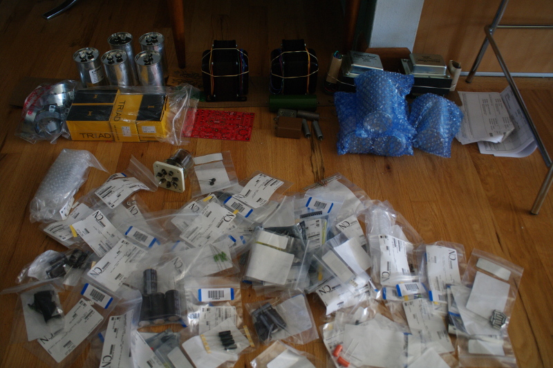

The fun begins! Done w/ decisions and pouring over data sheets, etc.
I went w/ the Cree SiC diodes.. I have discovered Mouser has a LOT of typo's in their product specs. I'll know if they work or not soon.
I should have the kt88 version up in no time. Then I'll build my regulators and get the gu-29 version running.
Aww, I've got no 7 pin sockets! Where's that package.. Guess it won't be this weekend 🙁

There are so many motor run caps, it will take up a lot of the space. What kind of the irons that you use for this new build? I'm thinking about it as a winter project as well. Happy new year.
Sidney
Sidney
Yes, I had 5 motor runs already... So, decided to go all motor run. (power supply caps, and then even the 4 that are doubled up on the PCB are being replaced by 2 motor runs) Then I'm also using old soviet capacitors for bypass, etc, which are also huge (again, I've already got boxes of them, so might as well use them).. You can see a few towards the mid-top of the photo. This will be a very large amplifier! I want the final design to sort of showcase all the large components, so need to come up w/ creative chassis design. I may have to put glass sides around the monoblocks... I'm still far from putting a lot of thought in to that, though.
For iron, I'm using what Pete recommends on page 14 of this thread. I couldn't make up my mind about what to build, so let him do it for me 🙂 (Thank you Pete.. else it could be next winter and I'd still be sitting here debating w/ myself on transformers)

What Output Transformer?
Pete
The picture of your test rig above shows a different output transformer from your Tango on the website. Can you tell us which model your using.
Pete
