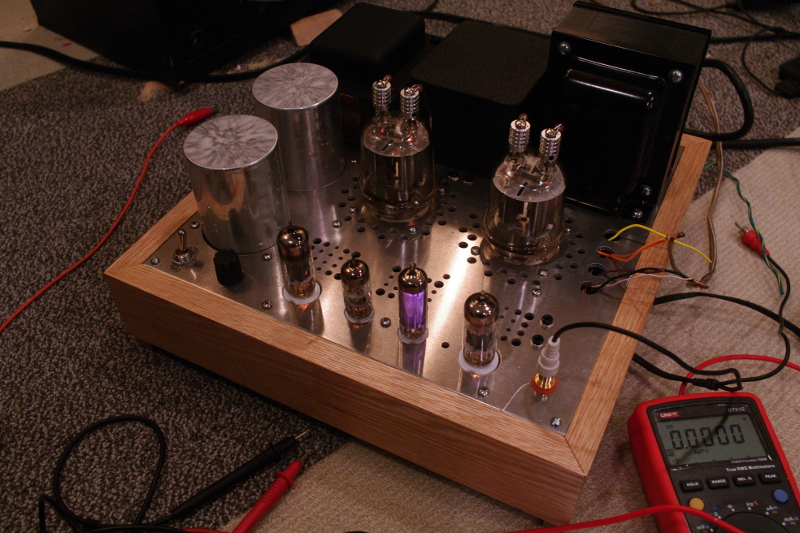

I finally got one monoblock completed and in its chassis. I've tested everything, and have found one problem.
I measure across the 10k resistors on the 12hl7 anodes to set the balance, and only measure about 4v on each resistor. In the other channel that's still just tacked together on my workbench, I measure about 9v across those resistors.
Everything else checks out fine.. the voltage at every pin of the hl7's match in both channels.
The tubes should be burning about 8ma. If I didn't have a 2nd amp to compare with, I'd assume (maybe incorrectly) that the extra power I'm not measuring across the 10k resistor is being taken across the feedback resistor. But, both channels should be the same..
I measured the V drop across r17 (set resistor for the 10m45), and get 37ma as I should, so the CCS is correct.
Here's the schematic
http://www.pmillett.com/file_downloads/ppdrv2.pdf
Any ideas?

did you adjust the driver balance pot? that pot is for compensating for unequal transconductance of the 12hl7's...
at setup, this pot is set at midpoint, then adjusted towards to the tube that has lower current...
if you have several 12hl7's you can test them for gm matching...

Yes, that's in balance, each at 4v drop. Other monoblock is about 9v drop across each 10k resistor.
I disconnected the ul taps local feedback (e-linear?), and it all biased up normally.
And I realized my comparison w/ my workbench copy was flawed.. 9v across 10000 ohms is only .9ma. So, there's more going on w/ the feedback than I understand right now, but both amps are functioning the same, w/in tolerances.
I think everything is ok.
you can series connect a 1k resistor on your CCS and then you can verify that your CCS is feeding the correct current...
