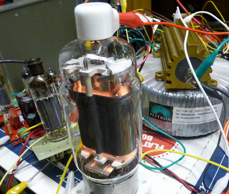

Pete mentioned transmitting tubes, so why not. It's just a test so why not go BIG. Well I have some 833A's, but I don't have the bench space nor a few KV, nor an OPT big enough to eat it......so think a little smaller.....Why not a pair of 813's. I know I could squeeze more juice out of some bigger sweep tubes, but a pair of brightly glowing DHP's would look COOL.
OK, I got tubes, sockets, and plate caps, so.....hook em up...light em up.....and....🙁 🙁 🙁 🙁 🙁
I have 4 tubes and ALL of them are DEAD.....🙁 🙁 🙁
One of them is so dead that I can measure 0 ohms between G2 and G3.
Well at least they look cool.

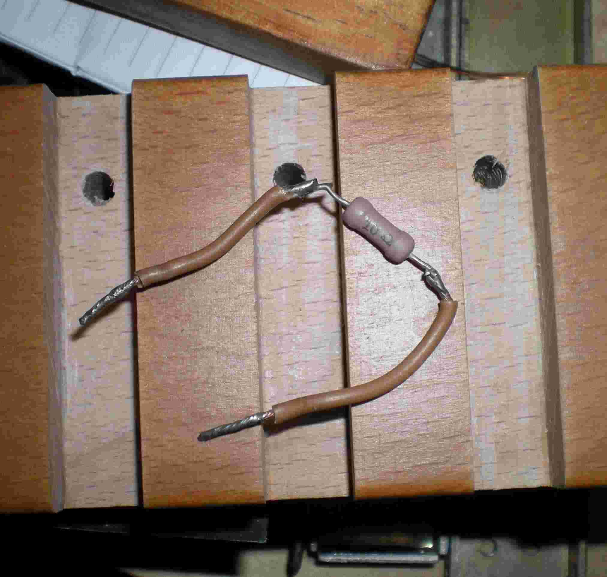

Still impressed with the memory of that resistor I went to look for mine....it's a two watter! Yes, I troubleshoot my amps with a two watter as a load. Serious lack of power here.🙁
Oh my God the size of that resistor!

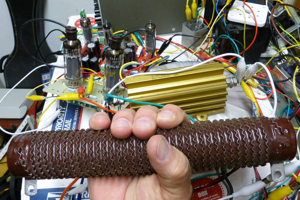

That's one of my little load resistors...its only rated for 120 watts, which I have already exceeded this week. Really big amps need a really big resistor. This one is rated for 500 watts, and I have fed it 525 watts using one of Petes big red boards and 35LR6's with both channels paralleled.
