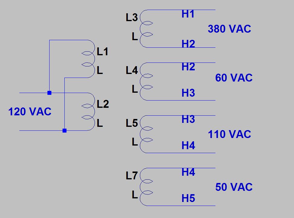

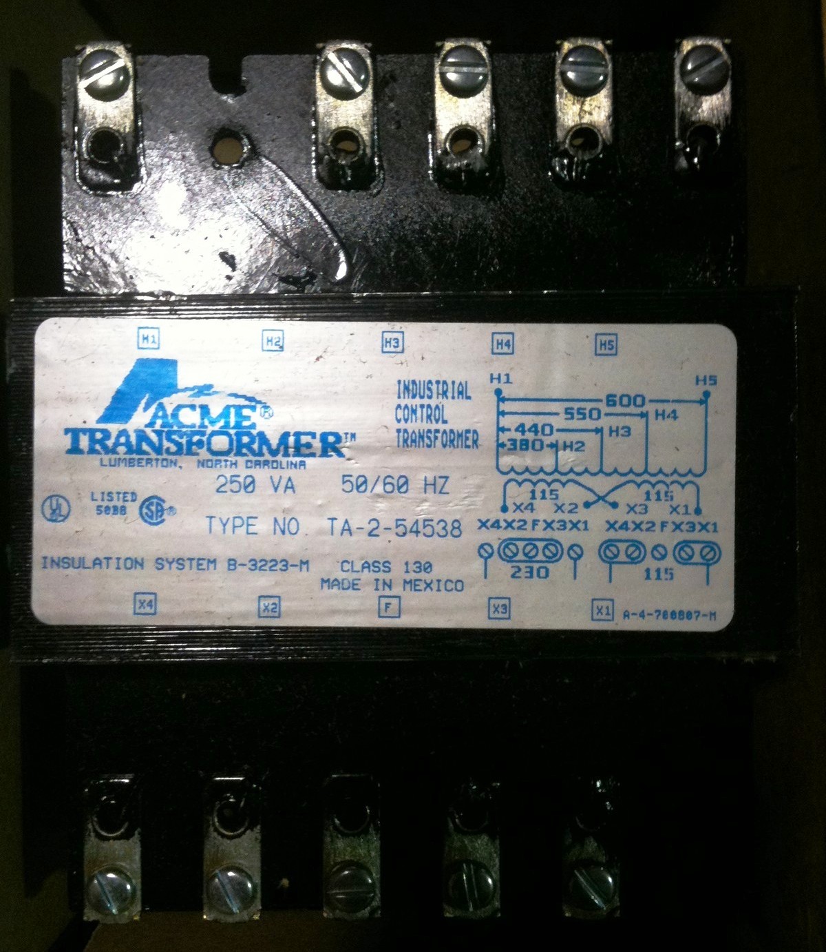

I am looking at power transformer options and many of you have suggested control transformers with 120 VAC connected to the original secondary running as a step up transformer.
Take a look at the pic of the ACME control transformer that has multiple secondary taps. Does anyone know if it is common practice in the construction of these to run the individual tap wires out to the screw terminal board? I have seen this type of construction before but have no experience with these control transformers. In other words, it allows you to break the connections to the windings at the terminal board and tease out the individual windings and separate them electrically as shown in the sketch.
